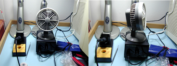

Well I went Goodwill shopping today and found a great little 5", double speed fan that works great at sucking solder smoke away from my face. I point the airflow away from my work area and it pulls the smoke just fine.
It cost me $4 and is small enough to fit easily on my small work bench... I saved myself about $50 getting this little fan.
Here are a couple pictures of it setting on my Hakko 936-12 unit...
Thought I would share.
