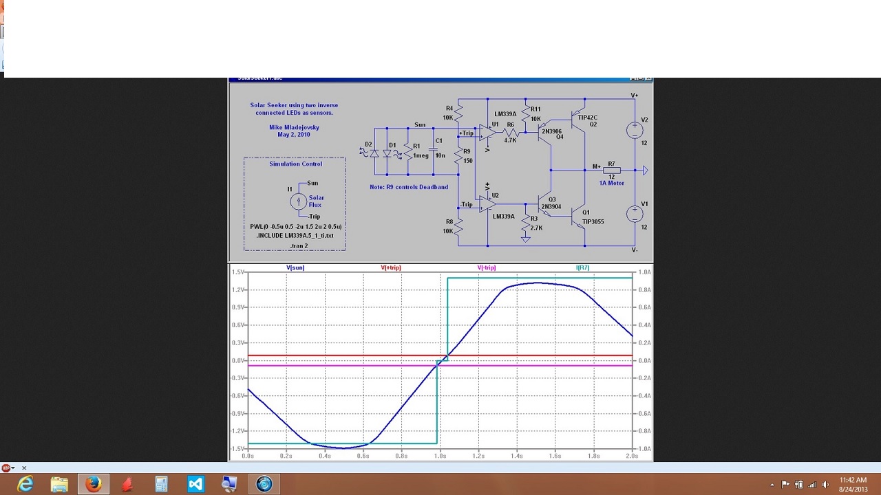

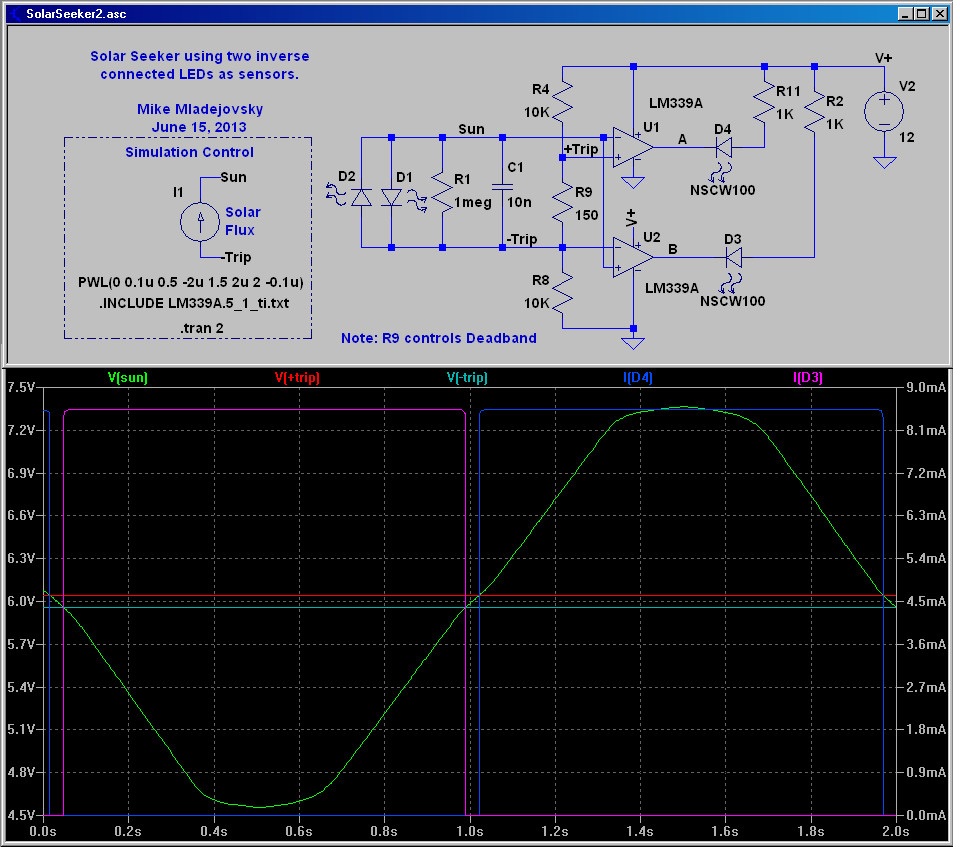

have a read in the renewable energy page, this is 2 that comes to mind. "simple-solar-tracking-circuit.106625/
