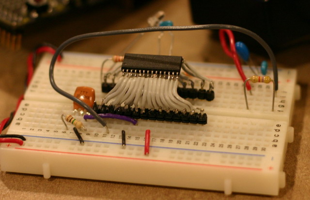

Ribbon cable has the right spacing for deadbugging SOIC. I did this many years ago.
