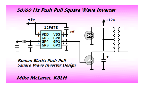

I am trying to develop program that will drive the MOSFETs of two channels of an Inverter/UPS. The complementary pulse width to each channel will be modulated depending upon the output of the UPS. I like to use software PWM utilising TMR, Interrupt etc. Please give some tip/hint or any link where I can have some idea on it.
The output of the UPS is square wave and frequency is 50HZ.

swapan,
What kind of a circuit are you using Sir? Something like this (below) which would drive one or the other MOSFET during alternating 10-msec half-cycles?
Regards, Mike

Then I don't think LTX71CM's approach is going to help you...
Can we Forum members brain storm this (give it some careful thought) and get back to you Sir?
Cheerful regards, Mike

Please don't take this the wrong way but do you understand what he's trying to do? Generate two PWM square wave signals, one for each half of the 20-msec 50-Hz cycle? I only ask because your example code didn't really come anywhere near the target.
Kind regards, Mike

If I were doing this from scratch I think I might use a 32-MHz clock and 256 interrupts at 78.125-usec (625 cycle) intervals (using the CCP module and "special event" interrupts). Use a 7-bit pwm counter variable and a 7-bit duty cycle variable (128 step soft PWM) and simply toggle the output pin pattern mask at the end of each 10-msec half cycle. Something like this perhaps;
;  void interrupt()             // 78.125-usec "spcl event" irq
;  { pir1.CCP1IF = 0;           // clear CCP1 interrupt flag
;    if(ctr.7)                  // if 10-msec half cycle
;      pinmask ^= 3;            // toggle output pin mask
;    ctr.7 = 0;                 // ctr %= 127 (unconditionally)
;    shadow = PORTB | pinmask;  // set shadow pin 'on'
;    if(ctr >= dcy)             // if pwm ctr >= duty cycle
;      shadow ^= pinmask;       // set shadow pin 'off'
;    PORTB = shadow;            // update port pins
;    ctr++;                     // bump pwm counter, 1..128
;  interrupt interval = 78.125-usecs (625 cycles @ 32-MHz clock)
;  7-bit (128 step) soft PWM
        bcf     PIR1,CCP1IF     ; clr CCP1 "special event" irq    |B0
        movlw   b'00000011'     ;                                 |B0
        btfsc   ctr,7           ; half cycle? no, skip, else      |B0
        xorwf   pinmask,F       ; toggle output pin mask          |B0
        bcf     ctr,7           ; ctr %= 127 (unconditionally)    |B0
        movf    dcy,W           ;                                 |B0
        subwf   ctr,W           ; C = 1 = (ctr >= dcy)            |B0
        movf    PORTB,W         ;                                 |B0
        iorwf   pinmask,W       ; turn output pin bit 'on'        |B0
        skpnc                   ; ctr >= dcy? no, skip, else      |B0
        xorwf   pinmask,W       ; turn output pin bit 'off'       |B0
        movwf   PORTB           ; update port pins                |B0
        incf    ctr,F           ; bump pwm counter, 1..128        |B0

Based on the sample circuit shown, I think you will get some RFI ringing from those MOSFETS which could be a problem for nearby low frequency wireless systems and possibly cause some spikes on your output. If this is for commercial use it will probably not pass EMC testing.
I draw your attention to section 2.4.4 in this pdf.
https://www.electro-tech-online.com/custompdfs/2010/09/szza009.pdf
