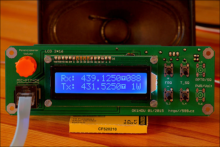

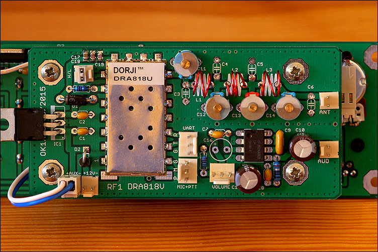

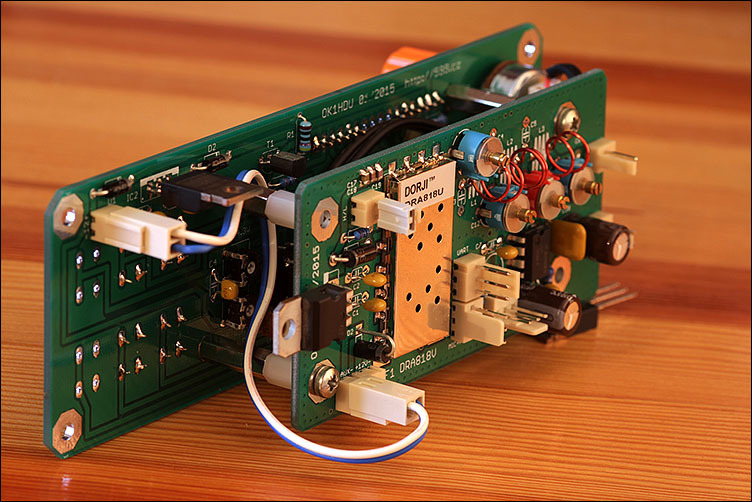

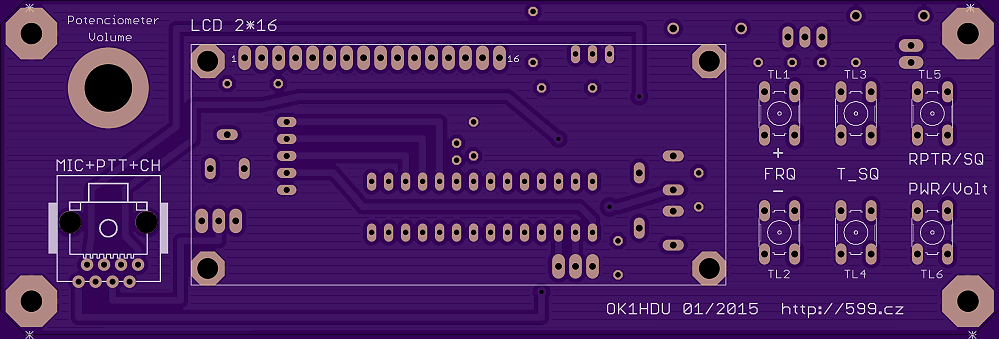

I would like to make a SCR with a DRA818U radio module. See attached PDF.
I want to control it with a PIC, I have 16F648A PICs which may work.
I will need a program to control it, any ideas welcome.
It should be able to send and receive voice or data, so should be interesting.
I WILL ADD AND CHANGE FILES HERE, AS THEY DEVELOP.

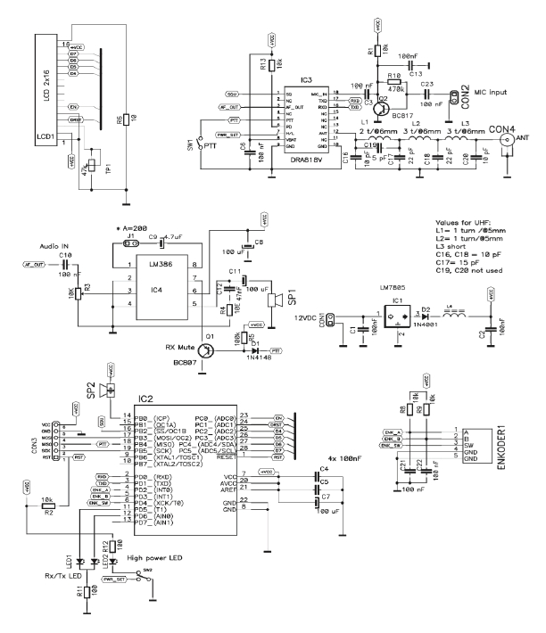

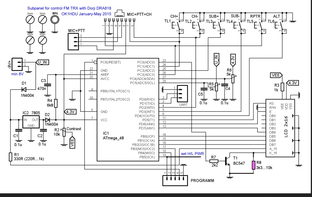

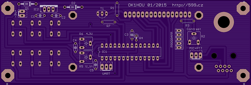

EDIT: Here are translations from http://599.cz/view.php?cisloclanku=2015052801 website by Jarda ok1hdu.
As the ATMEGA48 isn't fully supported, I am hoping to use an 18F2431PIC instead (both 28 pin) It looks as though I will need to make an adaptor, as it looks as though they can't be used pin for pin. I am trying to convert EricG's 18F4520 program onto it. So far I've changed the LCD connections to suit.
Apart from the above complete radio, one of my interests is sending and receiving data. I think the DRA818 can be programmed by a terminal (e,g, Putty) and simply send or receive data to or from a base receiver, for e,g, balloon tracking etc. I'm going to try this first

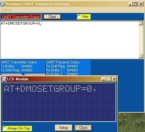

Made a start on the program (see #1). Any assistance in writing a section of code using the data sheet would be welcomed. I'll test it and add it into the latest program, this would help a lot. All I'm after to start with is the simplest of configurations, so anything is good.
C
hi C,
A simple working Sim example.

Hseropen 9600
setgroupstr = "AT+DMOSETGROUP=0," 'Initial value of the string
Hserout setgroupstr 'Sending string to DRA818V
Lcdout setgroupstr 'Show values on a display

Hi Eric,
Well done, it compiles ok.
I'll test it with the module next.
The actual pic from the Czech website it an 18PIN ATMEGA48, so I'll try to change the program to a 182431 PIC and see if I can get the pinouts to connect.

Have you checked that your interconnecting logic levels meet the requirement of the PC, PIC and 818.??
E
hi C,
E

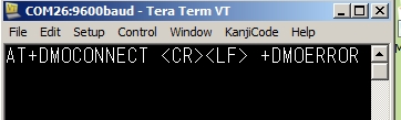

Hi Eric,
What I'm testing first is the radio module, so no PIC yet.
The 818 data sheet suggests TTL, which I read covers 3.3 and 5V. I am using a FTDI usb serial adaptor, and started at 3.3V then tried 5V no affect. Also I get the error response which may show that I am using the correct settings?
From the little I've read, it's possible that the error is something wrong with the sending sentences, even though I simply copied an pasted the suggested handshake sentence.
C.

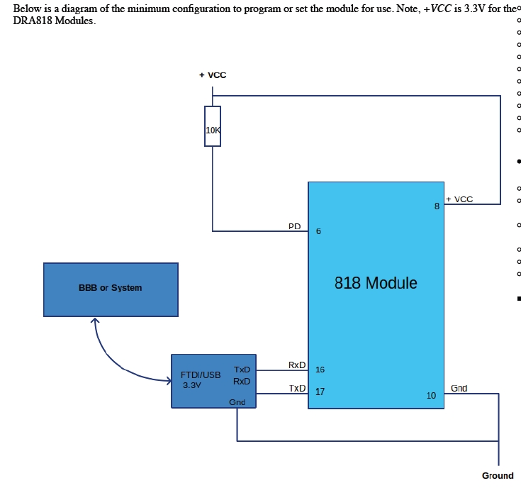

OK,
On this message,
AT+DMOCONNECT <CR><LF>
I guess you didn't type <CR><LF> as part of the message.????
I would type AT+DMOCONNECT press the Enter key, then send it, so it see's AT+DMOCONNECT crlf
E
Hi E,
As digits are typed into the terminal, they get immediately sent, so no 'enter' key.
Here's 'a' being typed, then copy and pasted each line in turn, showing the immediate +DMOERROR.
C.
a+DMOERROR
AT+DMOCONNECT +DMOERROR
AT+DMOCONNECT CRLF +DMOERROR
AT+DMOCONNECT CR LF+DMOERROR
AT+DMOCONNECT <CR><LF> +DMOERROR
EDIT: I'm wondering if it could be something to do with cutting and pasting and formatting etc.
hi C,
Its important that the end of message CRLF is sent.
Which program are you using to talk to the 818.?
E
Just an odd thought, for CR LF are you typing the letters C R L F on the keyboard?
What the radio chip is expecting is <CR> and <LF> ie the ASCII characters for <Carriage Return> and <Line Feed>
To produce these using a terminal emulator program you need to type:
<Ctrl> M for <CR>
and
<Ctrl> J for <LF>
hi C,
E
Hi Both,
You can see the 3x variety of CRLF I 'pasted' in post#13.
I use Teraterm.
I'll try the ascii alternatives.
C.
I've tried 'every' combination of inputs, and run out of ideas. I also tried Putty, where I found a CRLF tickbox instead of adding them, no n good. I've got some more modules on their way, so we can see if they are the same.
C.
hi C,
Looking thru the 818 datasheet I do not see a +DMOERROR message listed, which is puzzling.?
E

hi C,
Found this on line.
Extract:
I am currently working an a proof of concept Allstar node using this Dorji
Module. I just got the module on the air as Allstar node 29061. I used a
modified FOB and the DRA818U module. The module works well and has nice
audio and running 500mw.
I did have issues programming the device. Any commands sent were responded
by an error command. I found an Arduino Library that I thought I would
try to help determine the root cause and see how someone else programmed
the module. It also gave the same results and I was afraid that the module
may be bad. I added a CONNECT command to the library to see how that would
respond. After adding the "AT+DMOCONNECT\r\n" command prior to other
commands, it work as it should, not it's not clear why.
