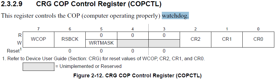

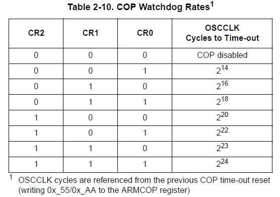

It was not that I did not believe you, but I found it hard to believe that your MCU would not provide a means to disable the watchdog function as this would just be a silly way to design a part. After all the development stage is not the time you want your MCU going into reset. Well to make it quick, I looked up your data sheet and found that you gave us some information that was not entirely correct concerning the WDOG disable.
The following tables were found on page 115 of the ST12X data sheet. From what I can tell, you should set CR0-2 to [000]. I think that should work.
Sorry I could not communicate properly to you. It is not that we could not disable the watch dog timer. In the production it is not accepted or not recommended to disable watchdog, so I have to enable watchdog.
