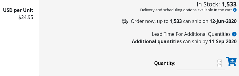

Wonder if UK will follow ? 21 June it is from Farnell in UK 12 GBP ( plus handling 4) 16GBP = 25 bucks ? usually we have to pay GBP = bucks
That price converts to 15.41 not including shipping United States Dollar which is about what they were in the USA a few short weeks ago. Microchip and USA distributors are all at 24.95 US at the moment. Yes at some point I would think they would increase

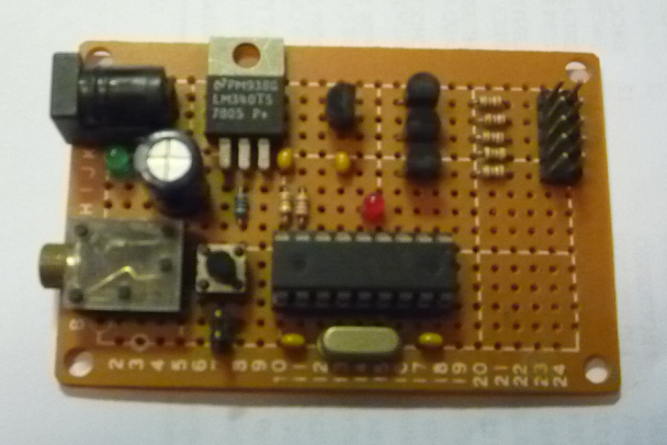

I'm a late comer, too. I think I used Bob Blick's version of David Tait's parallel port programmer design. Later I used that parallel port programmer to program a PIC for use in a serial port programmer. After several iterations of the serial port programmer, I finally bought a PICKIT 2, then a PICKIT 3 as well as a very nice PICKIT 3 clone. Earlier this week I received a PICKIT 4.
I'm encouraged by the more recent LVP (Low Voltage Programming) method on newer PIC devices which allows programming by something as simple as a $3 Arduino clone (or ESP32, or STM32, or Raspberry Pi, etc.), as long as you don't mind keeping the MCLR pin function...
Cheerful regards, Mike
