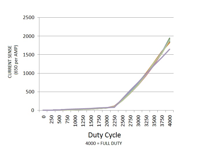

1) That I have a huge deadband for PWM, where I assumed the voltage (or current) across my motor would be linear with the duty cycle. I did a graph of the motor current as a function of my PWM duty cycle.. you will see several lines representing my testing at different shaft angles, and for each of my 3 motors.
(image attached)
So for my controller I've had to fit an equation to this data such that I can somewhat accurately command current to my motor.
2) The continuous current rating for my motor is 1.69 amps, which is well below the 3A continuous rating for H-bridge driver. At about half of this current value.. around 0.8A the motor begins to feel gritty when you backdrive the shaft... This is highly undesirable for my design.. since the whole point of my robot is to transmit smooth torque through the robotic linkage to a human hand.
I tried hooking up my oscilloscope over the motor terminals to see what the actual signal was doing... and this ended up actually changing the performance of my circuit.. and something didnt seem right.. so I pulled the scope of in fear that I might damage it..

The electrical time constant of your motor is about 375 microseconds. With that time constant I would use PWM frequencies above 30 kHz. Maybe even 40...60 kHz if you can get enough resolution from your microcontroller.
Some Maxon controllers use choke inductors in series with the motor. The motors have such low inductance that external chokes are needed to smooth out the ripple current.
I think that the nonlinearity of your current/duty-cycle curve comes from the low inductance of the motor winding and the low pwm-frequency. The current ripple is so high (in amplitude) that it gets cut off at low currents (i.e. it cannot go negative). Similar to a buck converter operating in a discontinuous mode.

Assuming you have 48V supply voltage, the ripple current of your application is about 0.6A. The minimum average current would then be about 0.3A for the ripple current to be continuous.
I think the numbers and your graph match close enough (the discontinuous corner of your graph is roughly at 0.3A). If you are using the "Sign/magnitude PWM"-mode, the ripple current is probably a little bit smaller.

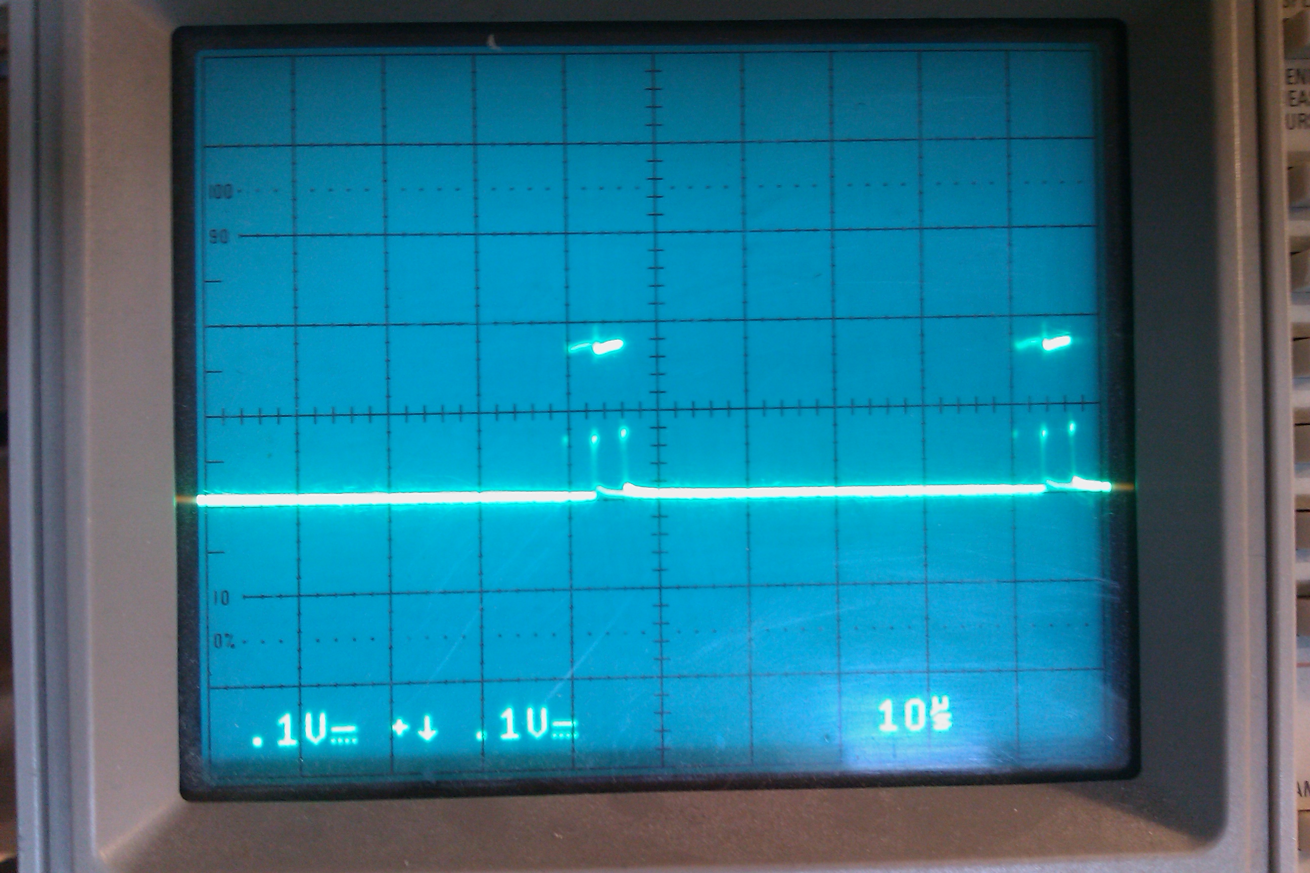

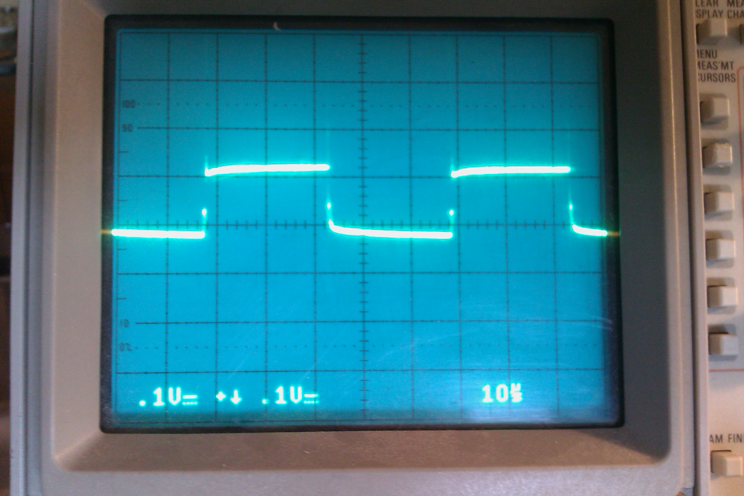

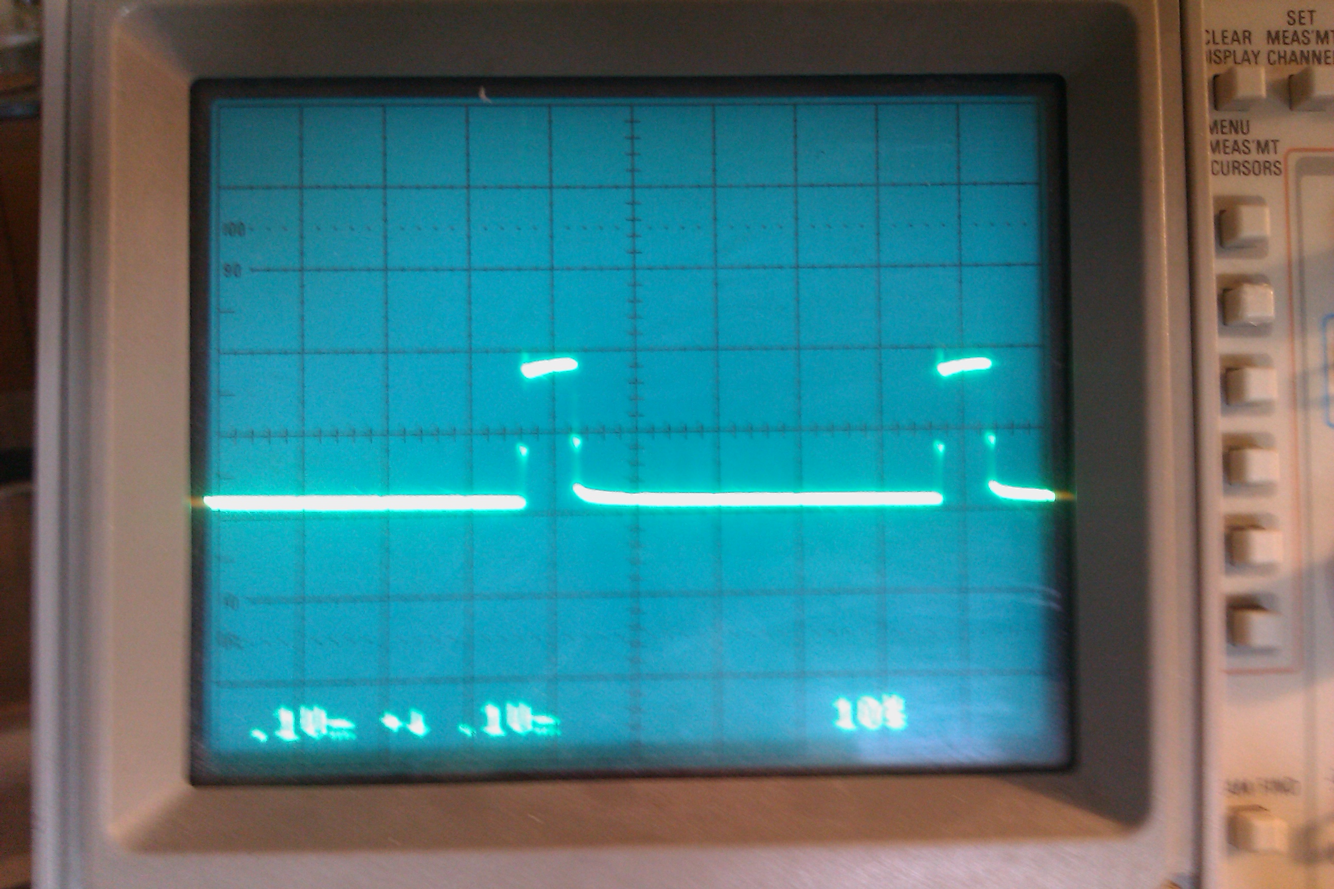

It would take a "differential input" (two probes, Chan. A and B set to same gain, Vertical display set to A-B) to look at the motor voltage. I'll bet you hooked the scope probe ground clip to one side of the H-Bridge. You are lucky you didn't blow up one side of the bridge...
Some scope plots of my PWM
Hey Mike,
You are correct.. and that makes total sense now! Damn.. I am lucky that everything is still working as it did.. I guess in essence what I was doing is hooking one of my H-bridge outputs to ground.. which when driven to my 18.3V Vs.. would draw a crap load of current through the scope!!
I think what happened is the LM18200t has over-current protection for its switches, I think that saved me. My scope is 10A fused, and my powersupply cannot out put more than 10A as it is.

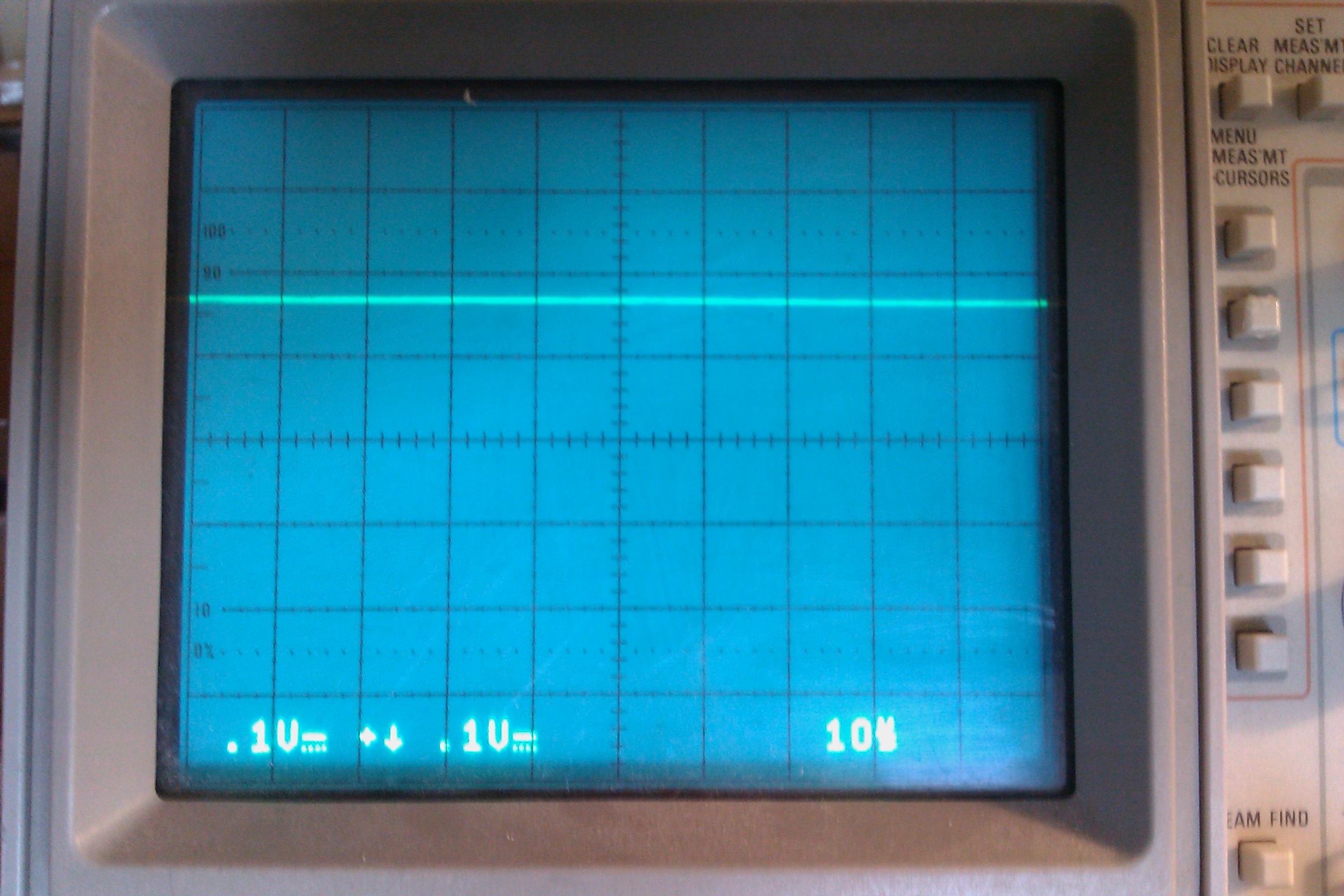

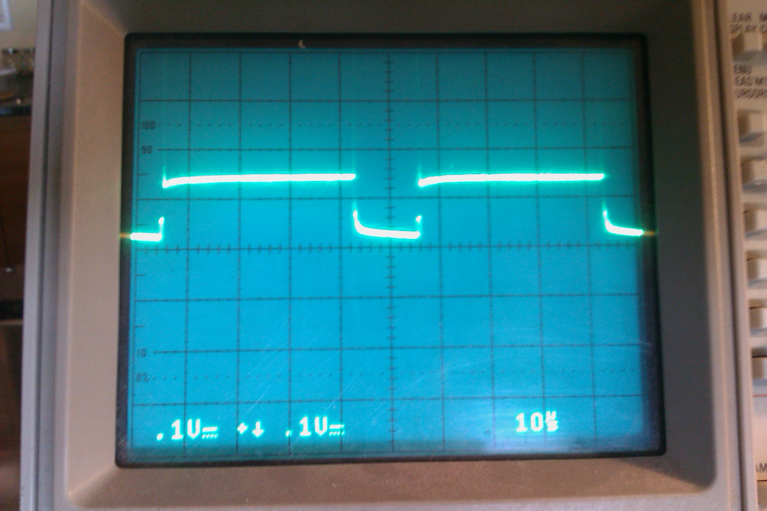

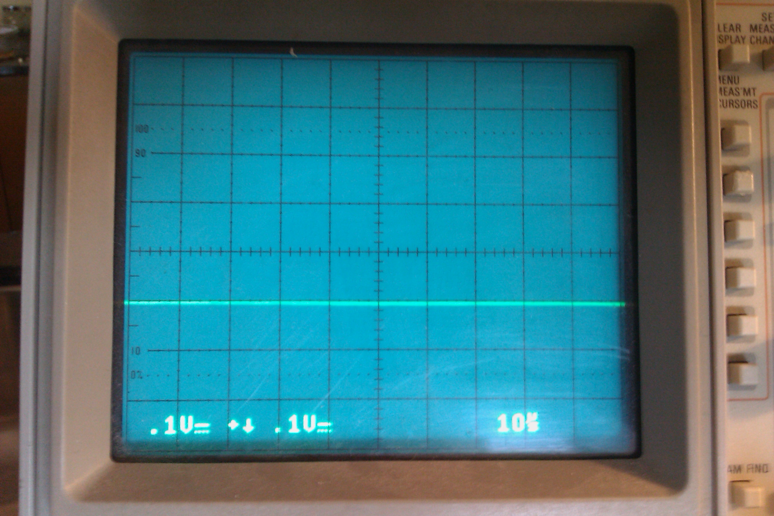

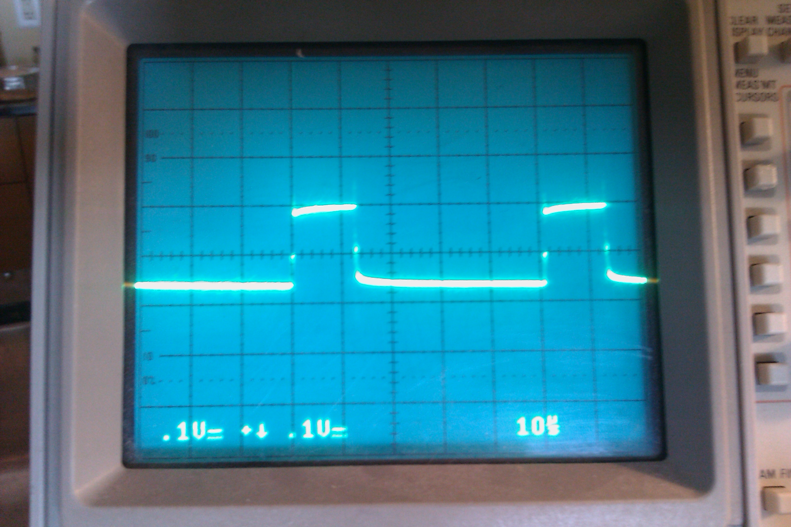

Anyways, with your advice I PROPERLY hooked up my scope and found the following results..
Im using 20Khz pwm with an 18.3V supply, and each vertical division represents 10V on my scope.
I've shown plots for pwm commands of: 0,250,500,1000,2000,3000 and 4000.. where 4000 is full duty cycle.
at this frequency I have a pwm resolution of 4000 in forward, and 4000 in reverse.

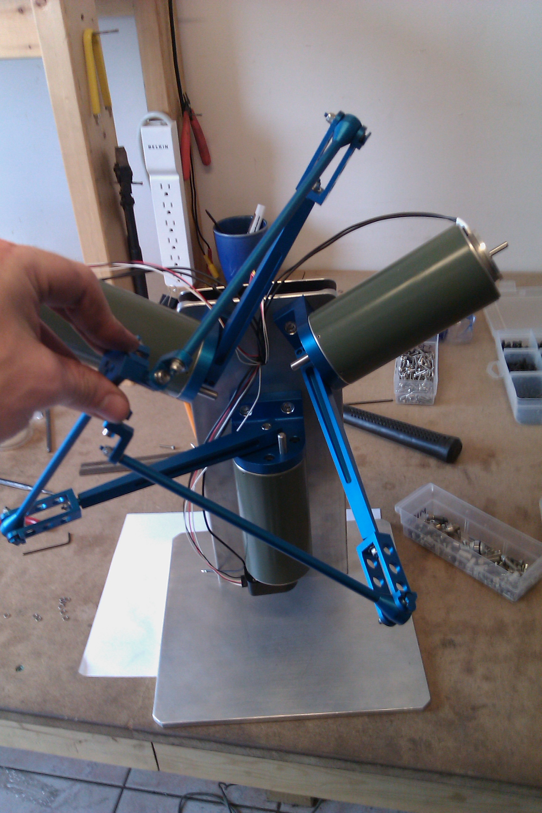

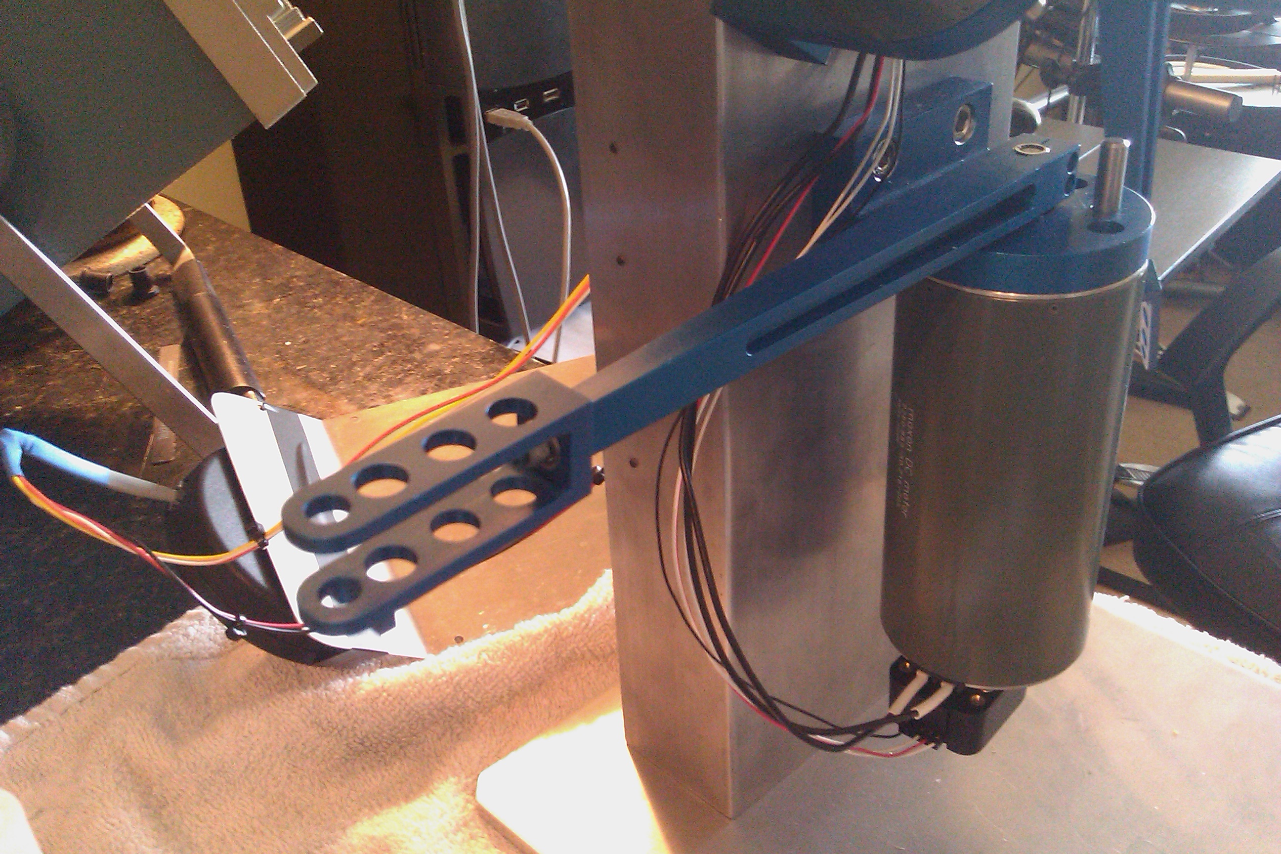

Here are some images of the actual haptic device.

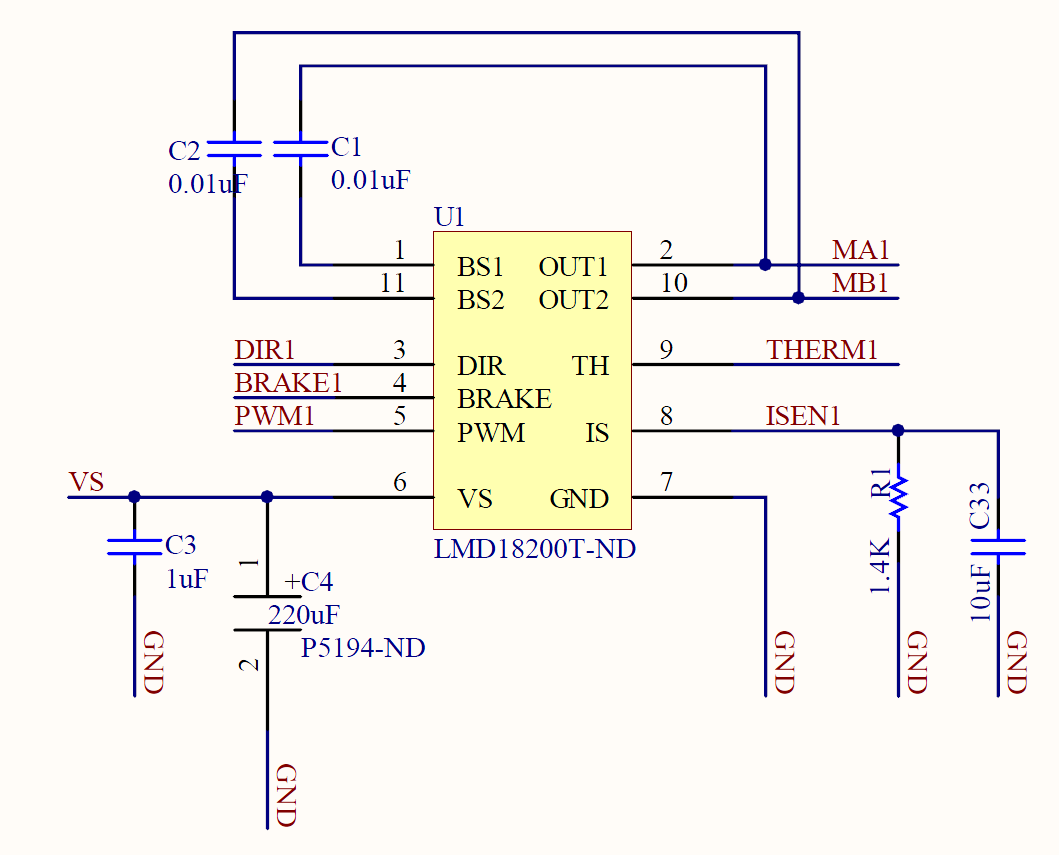

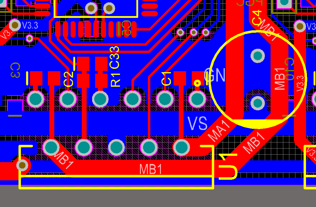

My Circuit for the LMD18200T's
I just realized that I only soldered the larger valued capacitor C4 onto the supply rails (the 220uF cap), the smaller filter cap C3 (the 1uF cap) has not been added because I missed it in my parts order list.
Im not sure if this would make a huge difference though, I've seen people doing PCB;s for the LMD neglecting the small valued caps on the rails.
