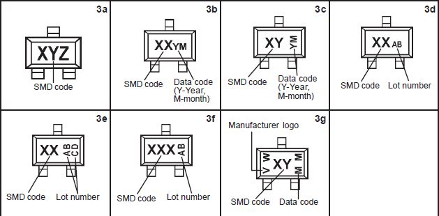

The diode is an SOT-23 package with two identically oriented diodes. The markings were "A4" then a sideways 7 next to that. Not sure what to make of the seven but when I look up an A4 diode, there is some indication it is a schottky, some not.

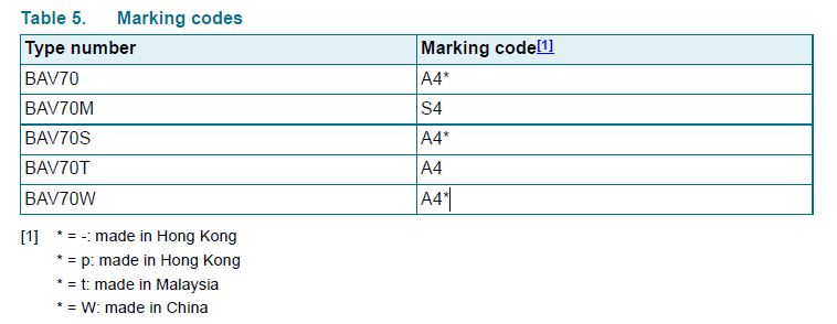

This could be it.
https://www.digikey.com/product-detail/en/BAV70W,115/568-6031-1-ND/2531318?WT.srch=1

I have not seen any explanation for the marking of a sideways 7, so I am just trying to determine if there is any significance there?
No idea. Date code perhaps?
From a little more checking around, I do think the 7 is a lot code.
