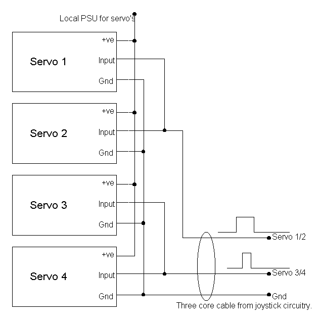

Here's a quick diagram of how to connect the servo's, there no addressing or anything, just two variable width pulses (a pair of sample pulses are included on the diagram), one for each pair of servo's. You could use 555 timers to generate the pulses from the joysticks, there are plenty of radio control servo tester designs on the net.
well this diagram kinds of explains more and in other word is almost perfect. however i still have a question, now...... i want to move the servo this much to the right, how the signal would look like??? and now i want to move the same servo that much to the left, now how would the signal ook like now ???
and if i will depend on the length of the signal to trigger up the servo, what kind of logic will be ised in the servo side, if any ????
thanx alot Mr. Nigel

The width of the pulses sets the position of the servo's, you simply vary the width, and the servo moves accordingly.
I've no idea what you would need to do for 500m of wire, you would need to experiment to see what happens - as a minimum I would expect to have to feed a fair amount of power into the cable to try and overcome capacitance and losses. It might not be possible at all, and a more complicated scheme could be needed.
But regardless, the circuit above is how the servo's should be connected, and shows the signals they require.

Hi falleafd,
I wasn't suggesting it was a complete solution, merely a starting point for experimention - the first thing you would need to find out is how far it would work over, obviously one factor that would affect this is the source impedance of the pulse generators. You could add amplifiers to increase their capacity, and you could also add buffers at the receiving end.
As for RS232, the distance available is inversely proportional to the speed (to some extent) - I see no problem working a great deal further than 10-15m at the kind of speeds require for working a pair of servo's (1200 baud would be more than fast enough). For that matter, how about 20mA current loop?, isn't that more reliable over longer distances.
My very first suggestion was to use a standard radio control transmitter and receiver, although now we know the range is 500m, it's probably a bit too far (apart from any interference problems). I also suggested using the encoder/decoder chips from the radio control system to send the signals down a pair of wires.
How about using a standard radio control transmitter and receiver, but removing the aerials and connecting them via 500m of coax cable?.
