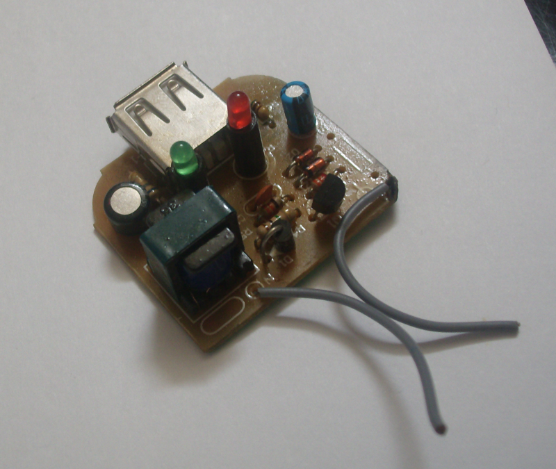

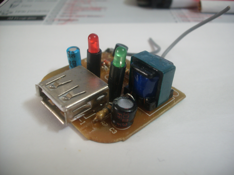

Hi all, i was thinking about those little cellular phone chargers and how they use those tiny transformers to supply 5v @ 500ma.
Where can i find these kind of transformers? I was thinking about just buying a bulk amount of chargers and taking the boards for my project but i would love to find out how and where to get the parts.
I live in US so its a normal 120v-125v from wall so i need something to step down that. So any links to possible solutions would be cool!
They aren't mains transformers, they are high frequency switch-mode transformers as part of a SMPSU.
As every single circuit uses a custom transformer you can't usually buy just the transformers, and the assoociated electronics to make them wiork would make it far more expensive than buying complete PSU's.
