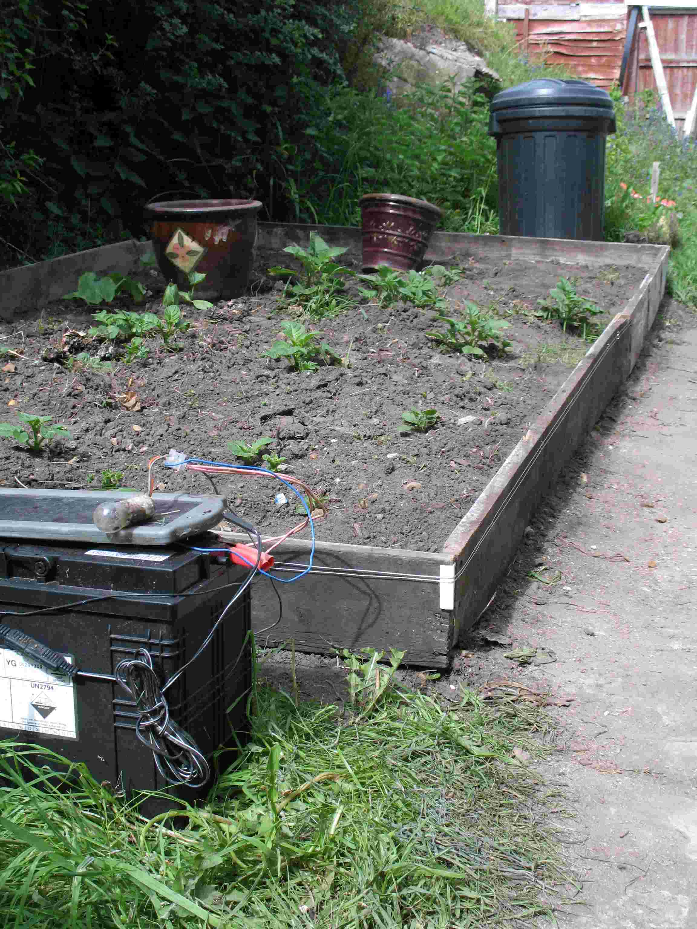

EDIT: 2015
Last years fence was a horizontal track of two 5mm tracks of copper fixed to lengths of plastic. While it worked ok, it gradually got oxidised over time. This allowed slugs/snails to get halfway across before their action cleaned off the oxidisation, then they got fried. This is not my intention, I only want them to turn back.
This year, after some thought, I made a wooden fence approx 6 inches high, with once again two tracks, but of stainless steel wrapped round the whole perimeter, approx 5mm apart. One to negative and the other to positive, in series with a light bulb, in case of shorting. Hopefully any deaths, will drop off. Last night was the first night, so I 'trained' a slug and a snail to try to cross. Neither did, so I assume it will work, and keep clean this time.
I used reclaimed wood for the fence and an old battery, with a solar charger. Plus the cost of S/S wire a few pounds, so very cheap.
Here's a photo: Not pretty but affective (I hope)
Camerart.

Today I fitted an AC transformer 12V 1A. I first checked the track, and had to clean off baby petrified slugs (And I don't mean scared) it seems the voltage is too high for them to turn back like the bigger ones do. I sprayed the track and the voltage went down to 2V, but there isn't a sign of green/reaction.
I wonder if a higher current will keep the voltage steady. Perhaps a lower voltage would still work with young and old, as long as it stayed constant when wet.
A note: Soil, and as I mentioned, slugs might need cleaning off the tracks, so an idea I had to invert it all onto a vertical 4 inch fence won't work as it would be difficult to clean.
Cheers, Camerart.

I wouldn't say it was sorted out yet, but yesterday I changed back to 12V dc (large battery) because of the wet voltage drop and added a canopy along around the perimeter. Today I cleared a couple of baby slugs off, and now wait for rain, to see what happens.
I have left the ground spike idea behind, because it requires a shortish gap between positive and the soil, or else smaller slugs can get over it. Also the varying effects of wet and dry soil.
I think two tracks 1/4 inch apart on a vertical surface about 4 inches up, with probably 6-12V ? and 3-5 Amps ? will be what I aim for next time.
Cheers, Camerart.
