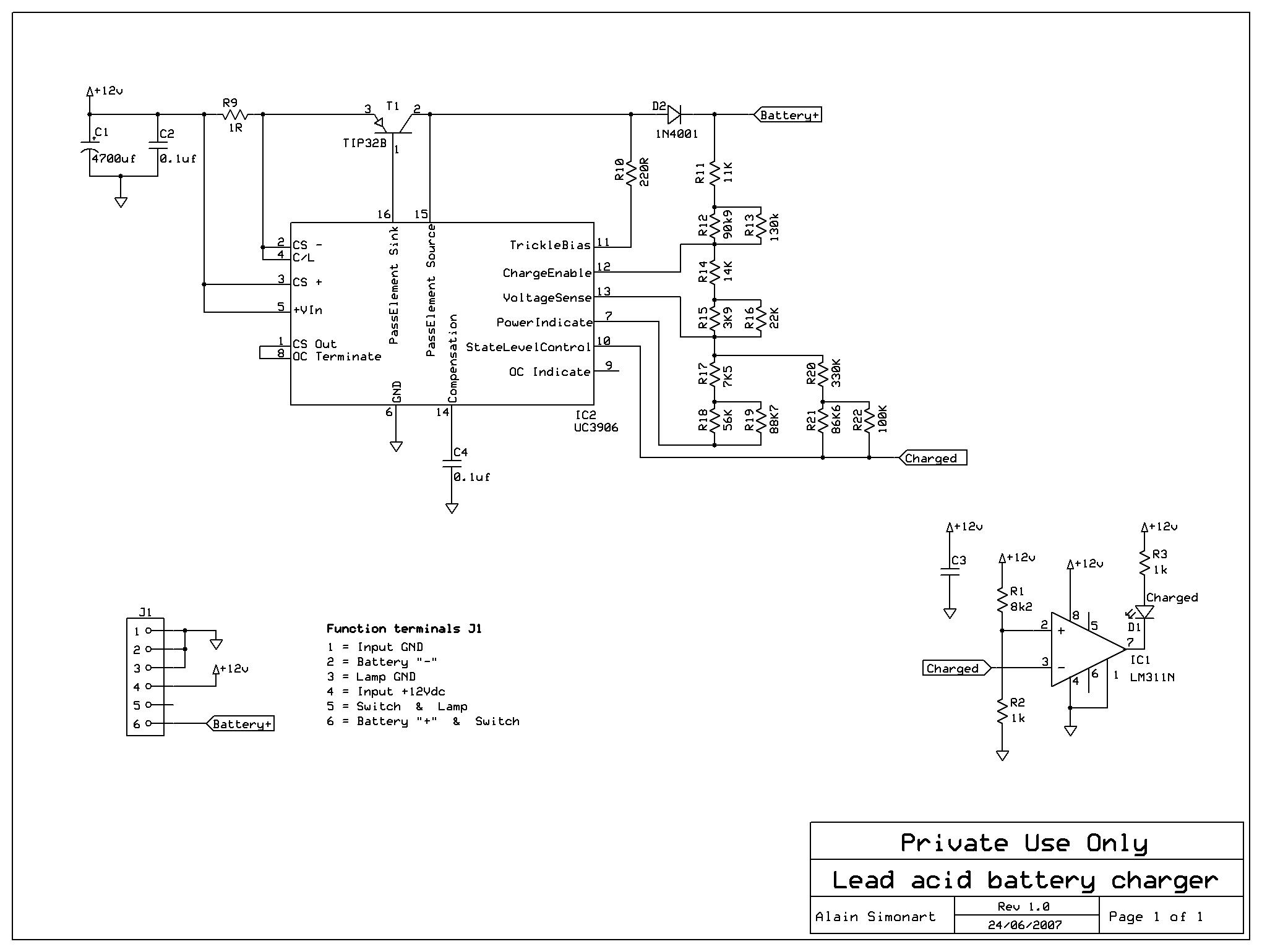

UC 3906 : Better than the rest
Just finished my SLA charger using a UC3906 from TI.
Attached datasheet, app note and my design for a 6V 4Ah battery
Sorry but can't upload the datasheet :(
You'll have to search the TI site
While you're seaerching don't forget to order your free samples.
Thanks again TI for mine :)
Like I read somewhere: "This IC based charger is a few orders of magnitude better than voltage or current based ones."
So please reconsider...
