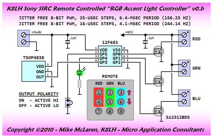

Mike - K8LH
My first attempt at doin' something with Sony SIRC so be kind (lol).
The program doesn't do anything fancy. It simply increments or decrements the Red, Green, or Blue LED duty cycle (0-255) using six keys on the Sony remote. Timing is precise and "cycle accurate" (no pulse-width or period jitter) with a pretty decent 156-Hz refresh rate. The program uses 155 words of program memory, 12 bytes of RAM memory, and no peripheral modules so it should run on a 12F629, a 12F635, a 12F675 or even a 55 cent 6-pin 10F200.
If you want to test it out on low current (20-ma) LEDs then eliminate the N-FETs and set the jumper to "active lo" for common anode 4-pin LEDs or to "active hi" for common cathode 4-pin LEDs and fire away. Don't forget your LED current limiting resistors.
Improvements will be adding a 64-step "gamma" table for 262,000+ color combinations. The colors will look better and you'll be able to adjust the color much faster. Right now it takes a minute to go from 0 to 255 or from 255 to 0 for each LED with a 205-msec "repeat" timer interval. Other improvements may include storing and retrieving color settings or animations from EEPROM.
Cheerful regards, Mike

Very nice. I'll look forward to studying your code later in the week. I will, of course, respect your copyright notice. I'm just curious.:D
It allows you to use a Sony remote control to choose any colour on a RGB LED.
What I meant with the question is rather about it's uses in perhaps RGB applications like RGB detection or sensors, but the answer lead to the way anyway. Thanks to both Mikes. :D

hi MikeK8,
As always an elegant solution.
As a point of discussion only, which part of the circuit do claim as copyright, is it the posted drawing, the circuit design or the PIC program.?

Here is the new K8LH SIRC RGB Accent Light Controller hex file with 6-bit (64 level) gamma correction and a very respectable 244-Hz refresh rate (8-MHz clock).
Now it only takes about 9 seconds to increment or decrement through all 64 levels of red, green, or blue and you should get much smoother color mixing.
The program uses 215 words of program memory and 15 variables so it should fit on a 55 cent 6-pin 10F200 with room to spare (lol). I'll post a 10F200 version of the program as time permits. Please note that the refresh rate drops to about 122-Hz on devices that have a 4-MHz clock (10F200, 12F629, 12F675).
More features on the way... Regards, Mike
