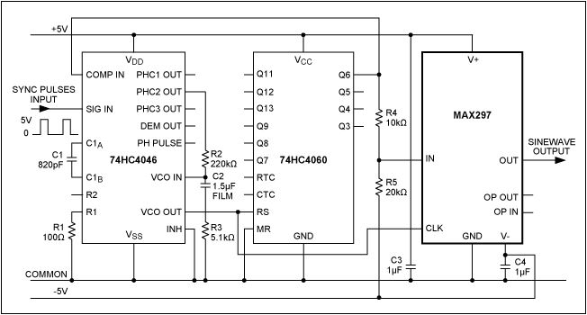

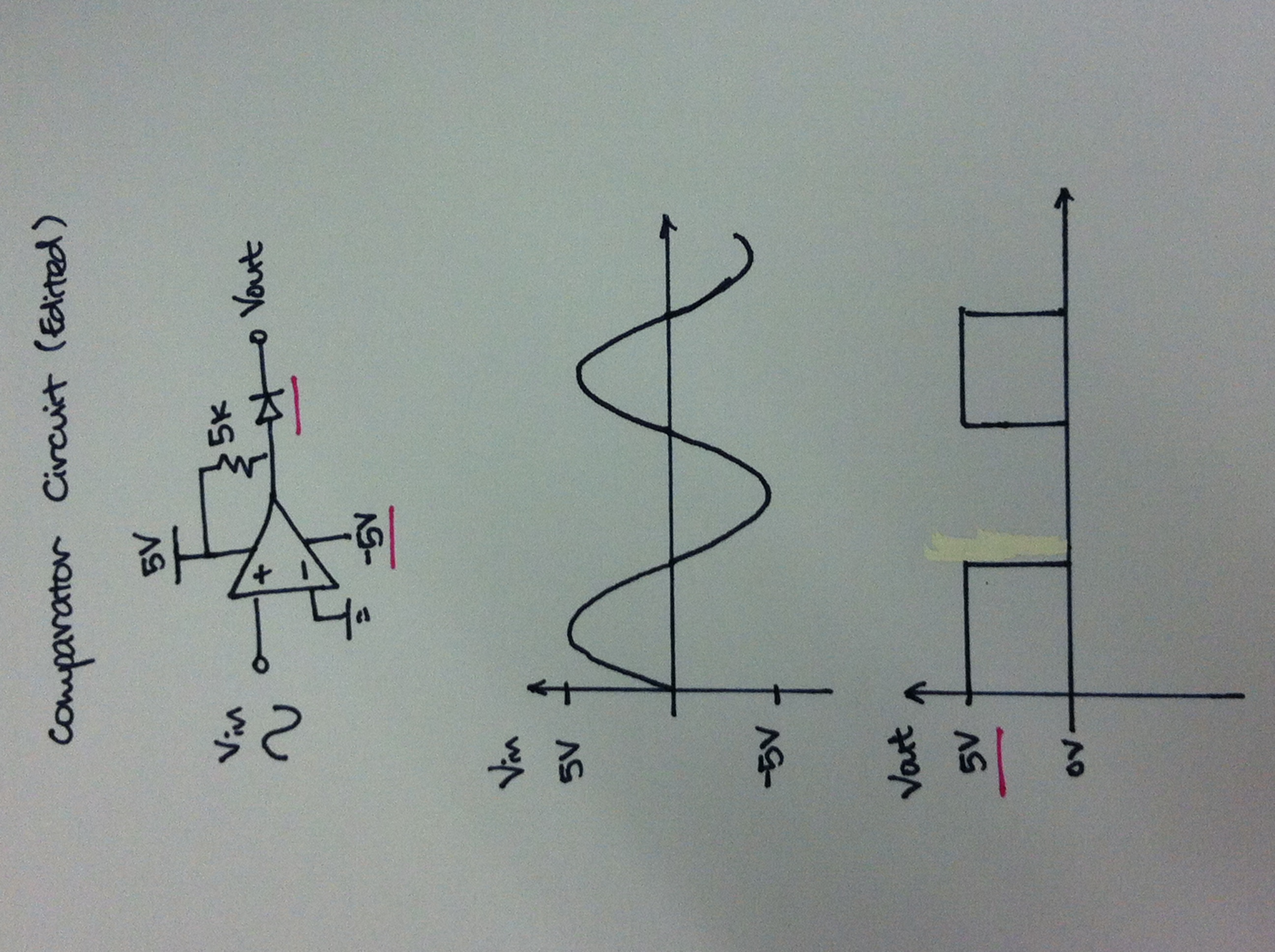

Hi all, i'm currently doing a sinusoidal phase lock loop and i don't have any idea how it works, but i have found a schematic that claims to work and produce a sine wave output. I have wired up the circuit, but i'm getting very high frequency noise as my output.
attached is my schematic for the square wave input as well as the pll schematic i have found.
The SIG IN pin of the 74HC4046 is floating and NEVER goes low. Add a 27k resistor to ground.

I think you must remove the negative supply and bias the MAX297 ground pin at half of 5V as shown in its datasheet.
The input to the mAX297 must swing from +1V to +4V maximum.
currently this circuit is based on a dual supply configuration (±5V), so is the mid supply voltage level 2.5V or 0V?
The datasheet for the MAX297 shows a single-polarity +5V supply. The input swings from +1V to +4V and the clock is 0V to +5V. The ground pin is biased at +2.5V.
If you use a dual-polarity supply (why bother?) then the input and clock both must swing negative and positive.

You show a comparator with no part number.
You show 4 'scope traces and none have a label saying what they are and none have 0VDC shown. If the first 'scope trace is the SYNC input then it is AWFUL, maybe because the inputs signal level is too high for the comparator input.

I think you have a problem with the circuit values.
I'm running with my Philips data handbook for the HCT4046A and fig 29 which shows the typical centre frequency as a function of C1. For C1 =820 pF, and R1 = 3 kohm, f0 is about 1 MHz. For R1 = 300 kohm, fo is about 10 KHz. Both these values are given for R2 = open circuit. The HCT4060 looks like it is dividing by 128. I dont like your value of R1 = 100 ohm, I think it should be around 10 K ohm to give f0 equal to say 400 KHz and the divider giving about 3 KHz. When I look at your waveforms and see horizontal values like 20 milli seconds, there is no way 100 ohm looks right.
The HC/HCT range of logic runs at 5 to 12 volt + with respect to ground. The MAX is an output filter and can run with a +/- 5 volt supply.

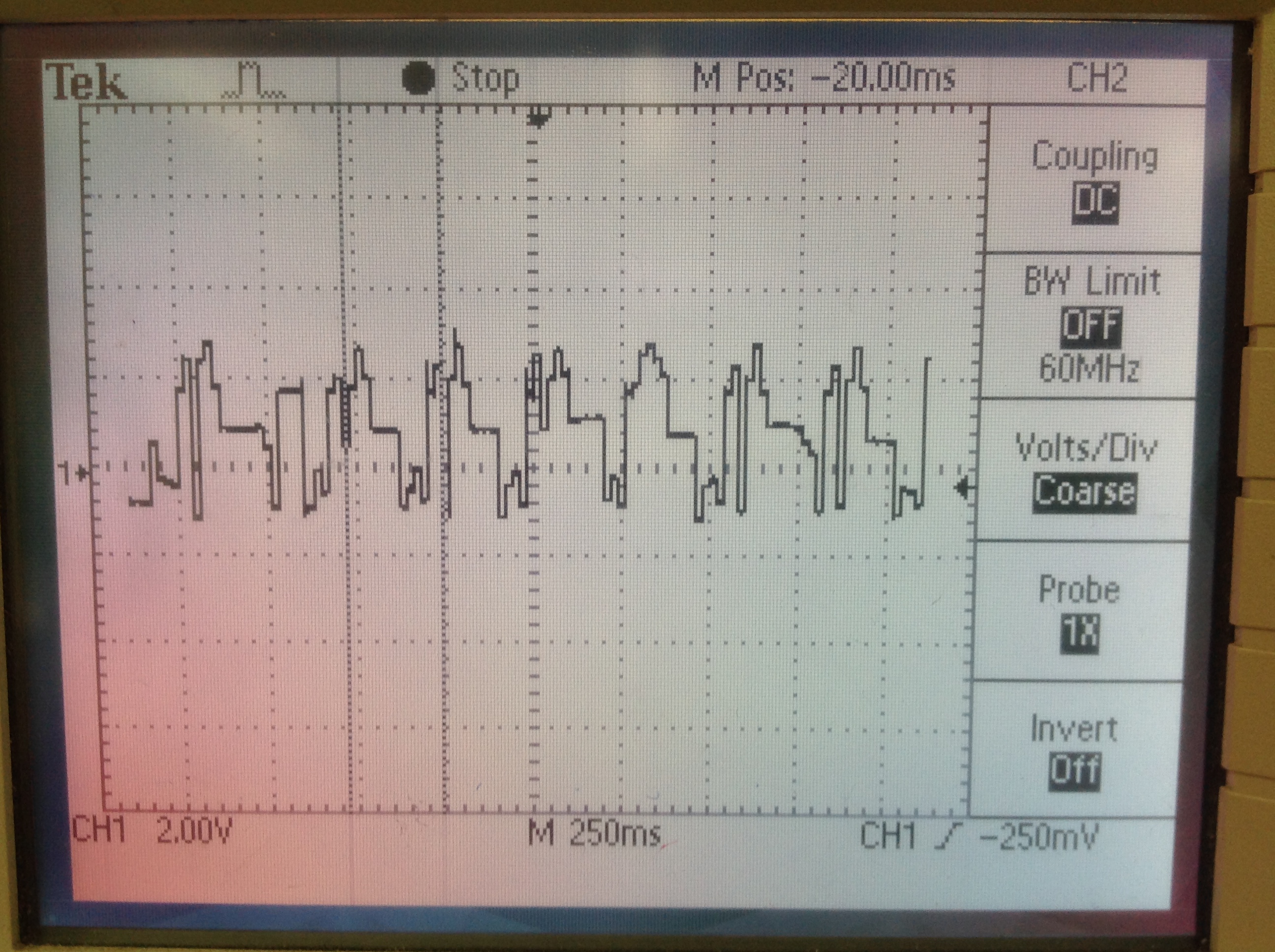

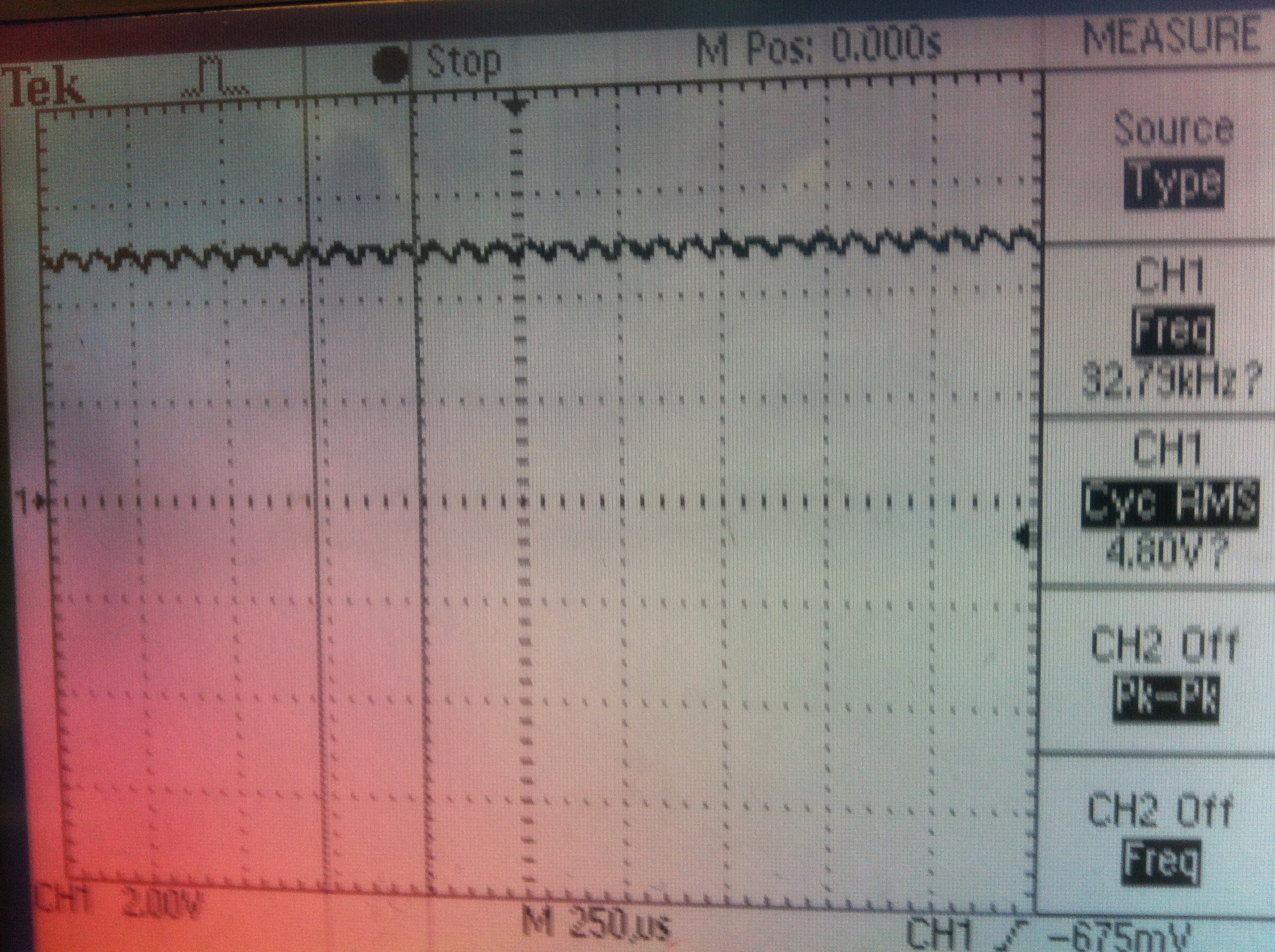

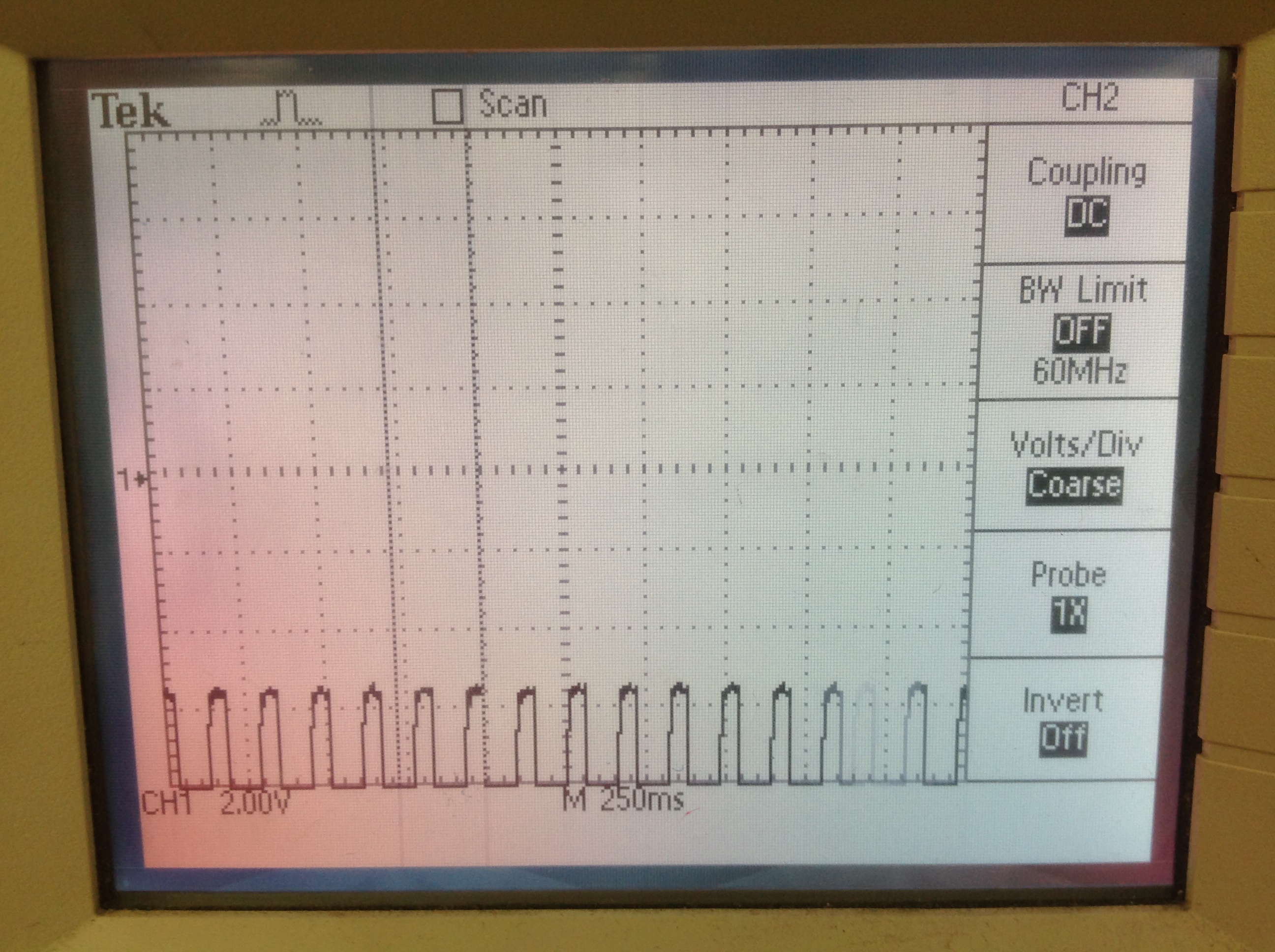

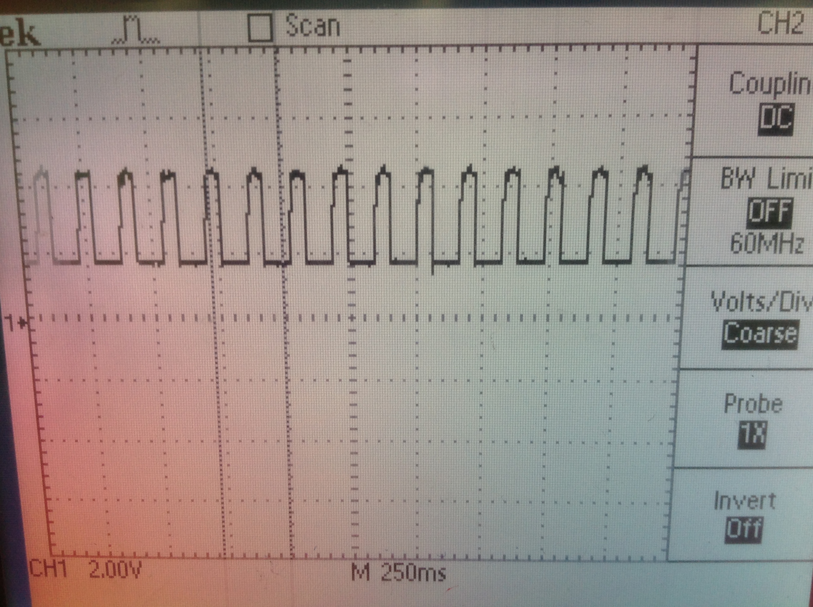

So sorry about that, the three pictures (in chronological order) are the supposed sine wave output after adding in the 27kΩ resistor, and the output signals from the DC generator when it is connected to the circuit.
The comparator that i'm currently using is LM 741 general purpose op-amp.
The DC generator is used to power my ic chips, set at a constant of +5Vdc and -5Vdc.

....the three pictures (in chronological order) are the supposed sine wave output after adding in the 27kΩ resistor, and the output signals from the DC generator when it is connected to the circuit.

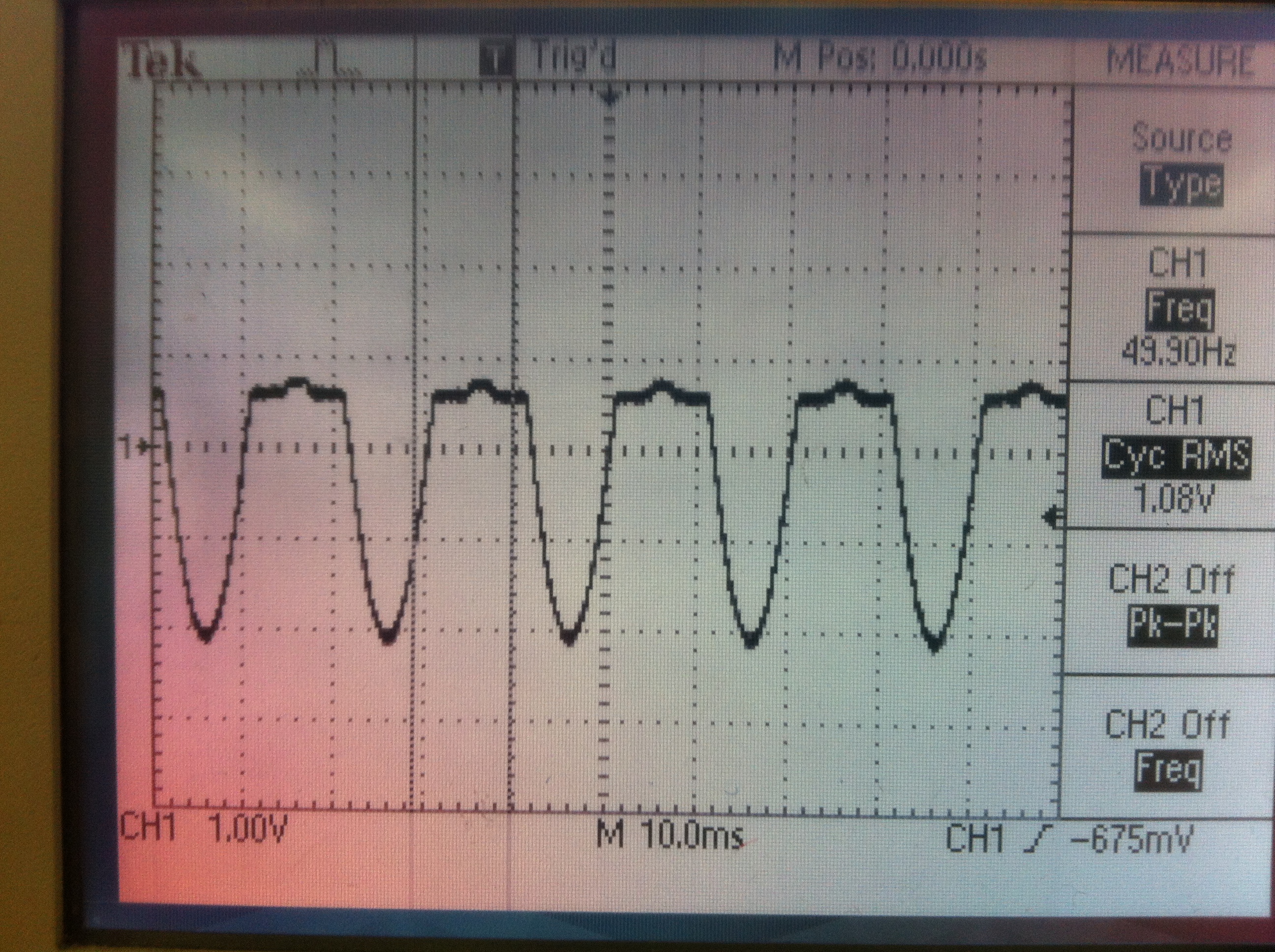

The output of the comparator is supposed to be a perfect squarewave but it cannot be since your power supply voltages are bouncing all over the place.
Why are the voltages of the POWER SUPPLY (it is not called a DC generator) not steady and are not plus and minus 5V? Your power supply voltages have big pulses instead of being steady.
What is your power supply that makes it so bad? A GENERATOR????
You haven't yet told what your circuit should do.
The original circuit was intended to generate sine output at frequencies 20Hz-20khz.
The pll should lock to input pulse frequencies about 2.5kHz-2.5MHz, so your component values R1 and C1 are too small.
741 is way too slow at the higher frequencies.
My bad. The power supply becomes so pulsated only when it is connected to the circuit, when i connect it directly to the oscilloscope, it shows a nice DC output. I have tried removing individual parts of the circuit, but that does not seem to have an impact on the signal of the power supply.

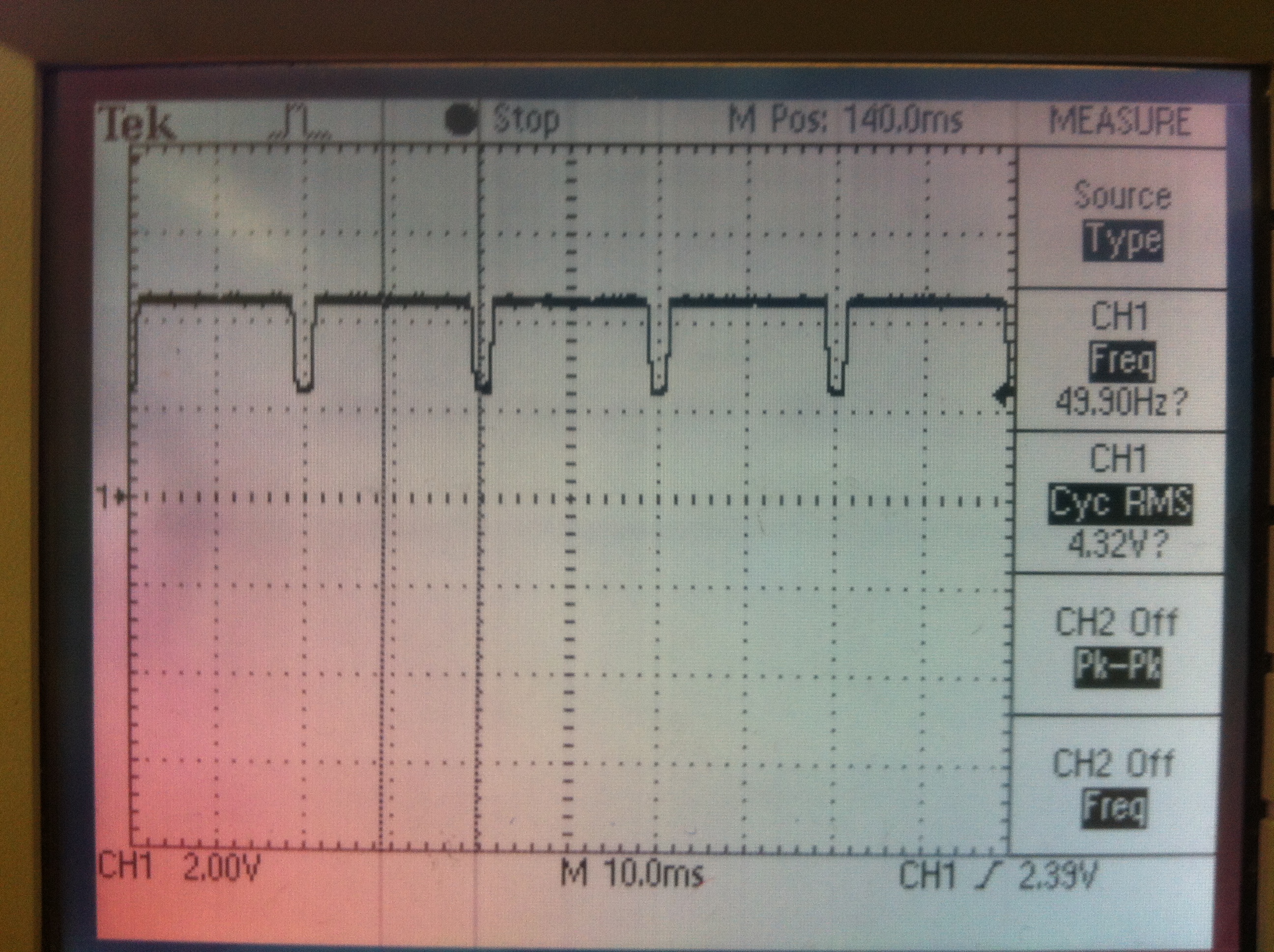

The circuit goes something like this: it converts a 50Hz sine wave input to a 50Hz square wave output that is to be fed into the PLL. After processing the signal, the output of the MAX 297 is supposed to produce a sine wave (assumedly 50Hz) that is locked to the input frequency.
By saying lock to input pulse frequencies of 2.5kHz-2.5MHz, does that refer to the output of my comparator? Because i'm trying to lock onto a 50Hz signal, do i have to change the input frequency?
Yes, you should change the input frequency to 64x50=3200Hz and component values so that the pll vco frequency locks to the input frequency or maybe the pll can lock to the harmonics of the 50Hz input, if you set the vco frequency near 3200Hz ?

Do you want to use a power supply that works properly? Or if you post the schematic of the one that is defective then maybe we can help you fix it.
Hi audioguru, the schematic is as posted earlier, but it seems to be affecting the power supply. I'm currently re-connecting individual circuits one at a time to find out which circuit is causing the disruption in the power supply.
Currently I have isolated the problem to the first circuit. when connected to the 74HC4046 chip, the power supply becomes pulsated instead of a nice dc supply, and the supposed 50%duty cycle pulse output from the LM741 is also distorted as shown in the pictures below:
Output of the LM741 Voltage Comparator
Power Supply -ve terminal
Power Supply +ve terminal
