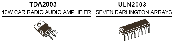

what is the use of ic2003.....s t a not gate..
There are hundreds of parts with "2003" in their part number. Here are two:

sir,
can u tell me what is the use of ULN2003.....if a high input consider 5v is given to ULN2003 what will be the output.

Maybe the school kid should look at the output voltage of the ULN2003 on its datasheet.
I wonder where the "5V" input is going to come from.
TTL and Cmos won't have an output of 5V when driving the darlington circuit.

The first page of the datasheet lists 7 things that they are used to drive.
I told you to look on the datasheet before.
mukeshrao said:
k then pls tell me what is the main purpose of ULN2003......why it is needed and where it is been utilized
Look at the attachments I have added.
The ULN has 7 individual Darlington connected transistors.
The ULN2003A has TTL and CMOS compatable inputs, this means that you can connect the inputs directly to TTL or CMOS outputs.
From the datasheet clip I have posted you can see that the switched output voltage of the ULN can be as high as +50V and it can handle upto 500mA.
NOTE: The product of the voltage and current switched must not exceed the power disappation of the ULN.
It is commonly used to switch relays or dc motors.
Does this explain it OK.?
