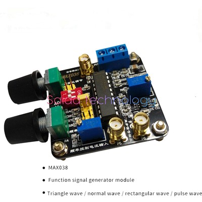

I made one of these a while back, it goes to 27mc, not sure if you can get the max038 to go to 30mc or not, but its a start:
It uses a MAX038 which has been out of production for quite a while. If you can find them they're going to be expensive.
Yes it is an obsolete device, you can still get them, theres a few on ebay in china, and a couple here in the uk for 20 quid.
I odnt know if theres anything in production like this still, they tend to be digitally controlled nowadays.
They even sell modules with the chip:

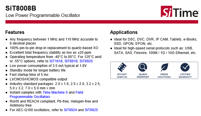

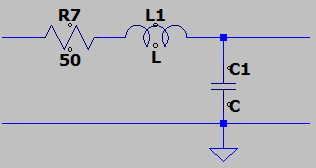

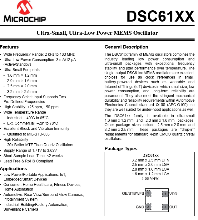

There are 100s of "programmable oscillators". They output is square wave so you will have to add a band pass or low pass LC filter to get sine wave.
You insert the oscillator in a programmer, run a program, type in 30mhz and then move it to your board. You can also order them from the factory preprogrammed.
