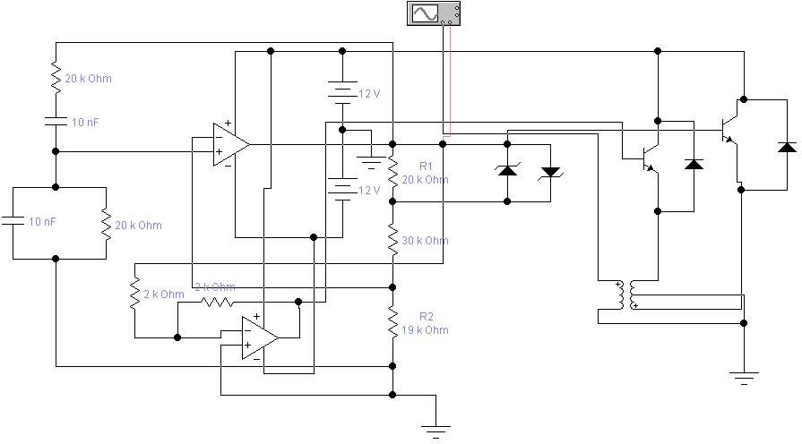

can you please comment on this circuit and its output
i have made this using a small transformer (500mW), without load i have got the given output wave.
I then used 500W transformer in the same way. But it draws very height current without any load. I don't understand why.
May be i am doing something wrong.

The output emitter followers will draw high current if the impedance (inductive reactance at frequency) of the transformer primary is low.
You will need one hell of a lot of transistors and heat sinks and diodes and ballast resistors to get 500W out of that circuit, if it would work at all. Not to mention some huge batteries. In other words, it looks impractical to me.
Use the class D amplifier as Hero999 suggested.
That's a basic audio amplifier connected to a transformer, with a signal generator on the input. For such high power levels you're better off with a class-D amplifier, such a simple little audio amplifier design is only suitable for <10W loads as it's ver inefficient.
