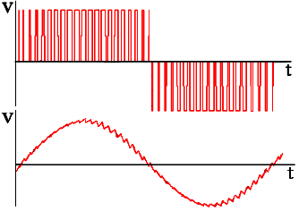

Here is an example of 3-level PWM showing what I meant which can be achieved with an h-bridge:
My follow up question was during the 0V parts of V in the picture above, should all mosfets be off, or two high/low ones on which appears to be the answer so current can keep flowing in the inductive load.
With a single supply to get the "0v" in the output, you have to switch off all the H bridge devices and wait for the current through the motor to decay to zero, else the inductive current will swing fully the other way and continue to conduct through the H bridge device parallel diodes. That is not ideal as you would need discontinuous current through the motor at the switching frequency. Another way is to add extra devices across the motor to short it out when all the H bridge devices are off. Not in my opinion a good solution. It is much simpler to go with +ve and -ve switching. By the way your diagram is a little wierd. It is not a sine wave unless you integrate the pulses.
1." The diagram is the same as fig 37.3 in the pdf you linked although realistically the current would fall a little in the off times."
No it's not, it is very different. In a real world motor, the motor drives something and this load tends to pull the current towards unity power factor. i.e. the current and voltage tend to align let's say a PF of 0.7 to 0.8. What you have is a pure inductor with no resistive losses. The real world load looks like resistive losses.
2. Thanks for the diagrams. That would give you 0v across the motor without extra devices. Nice! Hadn't seen that before, or if I had and I had forgotten.
3. Using the 0v will reduce your di/dt through the motor, which is desireable.
I see now. I just grabbed the diagram off google as it resembled what I was thinking but I didn't notice the phase delay.
This one is correct right?
