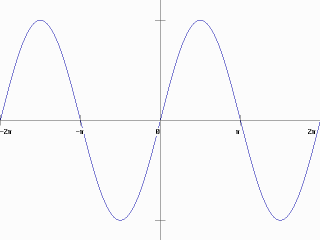

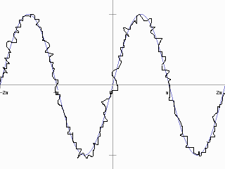

Today when someone asked me something about sine waves, we went for a way to see what job we have to do to get a signal like the bellow picture(the second)?
I mean suppose you have a pure sine wave(the first pic) and you want to get a wave form like the second by putting another small signal on pushes of the sine wave(like the second raw picture which I have drawn using Microsoft paint)
How to do that? what we can call the second signal? Is it related to modulation? Is it kind of modulation or if it has any special name in Electronics? Is it use in Electronics anyway?

As far as I know there are 3 kinds of modulation. AM, FM and phase modulatrion. So it would not be a modulated signal, So what it is?
Please don't say that it is a distorted sine wave because you can suppose it would be our desire signal finally not an odd signal.

A closer look a your second drawing revealed that the
superimposed signal is going back in time, that's going to
be a bit more difficult to achieve . . . :D

The modulation on the sine-wave is random. Noise is random so the second sine-wave is AM modulated a little with noise.

If you look closely at your modulation in the second image you'll find it actually goes backwards in time at some places.

It's basically AM, but using a low frequency carrier (with higher frequency modulation), and a very low modulation level.

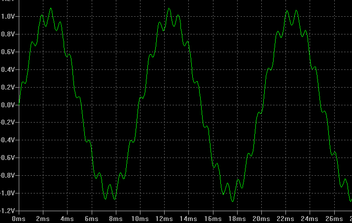

Hi Wizard,
Is this what you want to achieve ?
It's only an addition of two signals with different frequency
and amplitude, 100 Hz / 1 volt and 1234 Hz / 100 mV.

By the way, How did you generate
the wave on the pic?
I simply connected two voltage sources with different
frequencies and amplitudes in series. Sorry no magic.
You don't need a modulator to achieve this result.
It's so simple I'm having difficulties to explain it.
I think you need a knock on your head.
on1aag.

You can use an analog multiplier IC to perform modulation. Analog Devices sells many different versions Analog Devices: Analog Multipliers/Dividers :: Other. If you want to just add the two signals together you can use a op amp in a summing configuration.
Modulation multiplies the two signals together which gives you sum and difference frequencies.
Summing simply adds the two signals together. You end of with just the two frequencies, no sum or difference frequencies.
Which you do depends upon what you are trying to achieve.
