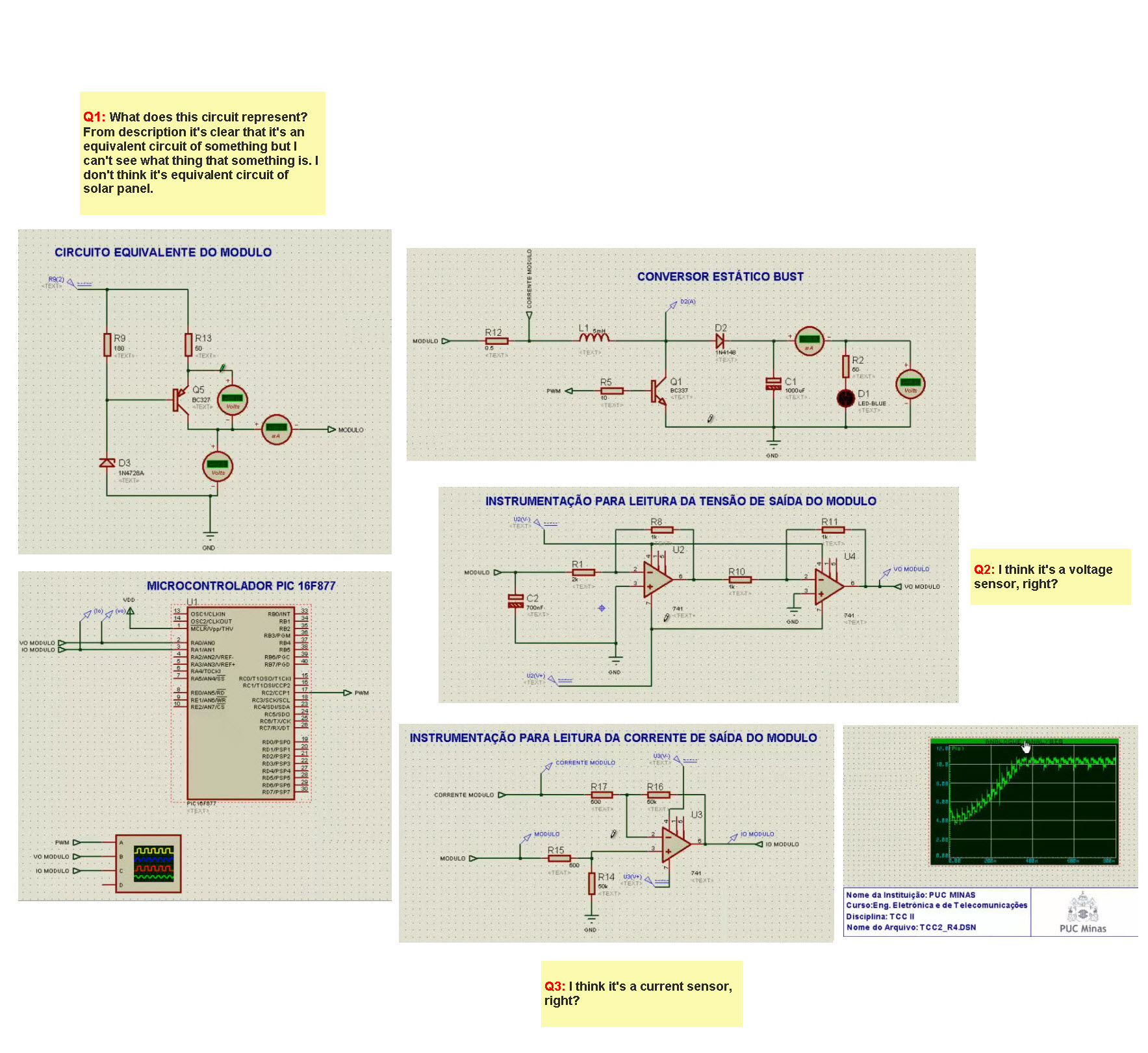

Hi
I intend to build the simulation for maximum power point based on the one shown in this video. I have tried to contact the uploader of the video but it seems he is no longer logs into his UTube account. Before continuing with the simulation I need to clarify few details. Kindly help me with these queries. Thank you.
Regards
PG
Q1 - It looks like this circuit indeed represent a solar panel.
Q2 - Voltage monitor and amplifier.
Q3 - Current monitor. But I don't see where R17 is connect. Because I don't see any "currente modulo".
Thank you.
Please have a look on boost converter on the top right. You will find "corrente modulo" next to resistor R12.
Do you think we should work on this circuit for simulation? If you have some better idea then kindly let me know. Thank you.
By the way, I'm trying to arrange the circuit components in ISIS and hopefully will be done tomorrow. But we will need someone's help for the code.

Hi
I have roughly tried to arrange the components. Please have a look here and kindly make some changes if you like.
Please also have a look on these queries? Thank you.

Q1 - you need to change Template. File ---> New Design --->Landscape US A
Q2 - simply zoom in and you will see that you in the grid, or simply change it , press F2 or F3 or F4.
I attach simulation file in rar.

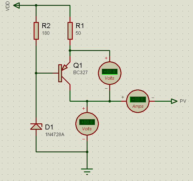

Hi
I don't see how this circuit can represent a solar cell. Could you please help me with it? You could also watch this video.
How do you represent a rechargeable battery Proteus? I don't think that Proteus has any library model for a rechargeable battery.
Thank you.
Regards
PG
