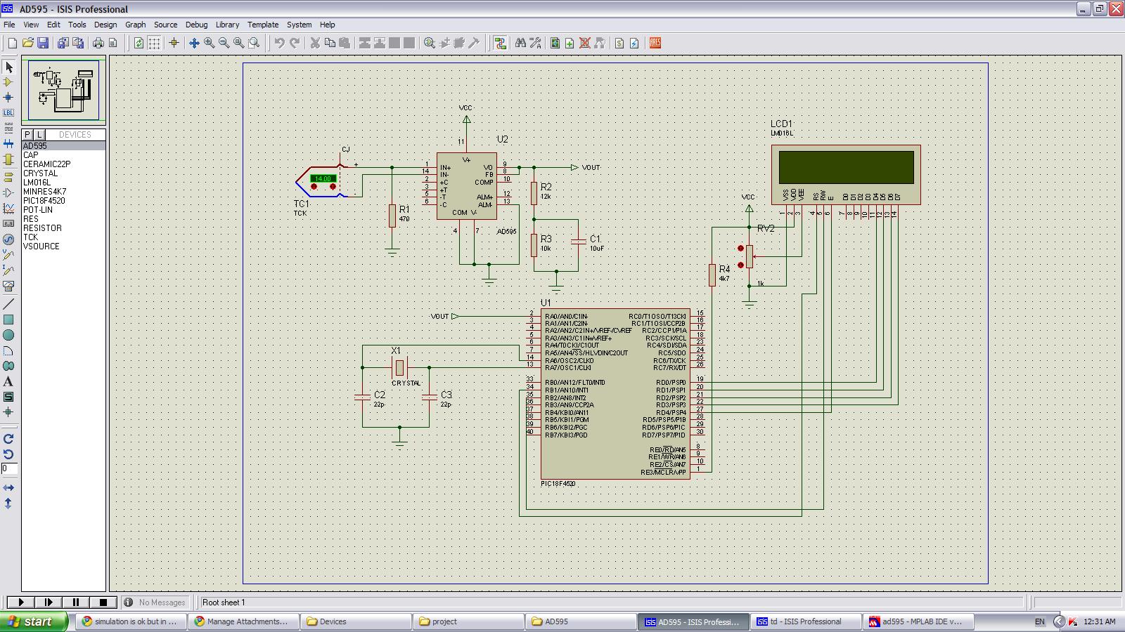

simulation is ok but in real device no display??
haowhaow
im newbie in programming.....
im using hi tech compiler, pic18f4520 and 16 x 2 lcd.....
after simulation is ok....but in real device, my lcd is blank .....
i dunno how to configure my code.....can anyone here helps me to solve it??
here is my code

Do you have a contrast control pot connected to the Vee (contrast) pin. The contrast control can be touchy and if it's not adjusted properly, you won't see anything on the LCD screen.
I'd post a link showing the connections but I have been forbidden to do so here.
The H-tech library Is for 4 bit or 8 bit mode it uses the lower 4 bits of the the PORTD And PORTA 1-3 for control lines You have to init one eight bits or four mode.
You have not set any mode you don't set the fosc 4 mhz 20mhz etc which errors the delay?
