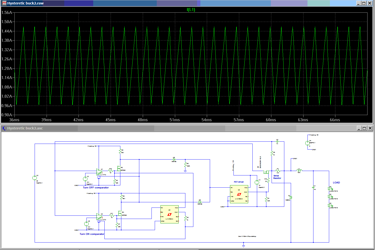

Your problem with uneven switching appears to be a simulation anomaly. If you add a value of 5us or so to the Maximum Timestep option in the Simulation Command window, the switching becomes even (looking at the inductor current).
thanks, but I just made the "maximum timestep " equal 5u (it was blank before), and it made no difference

Here's a screen shot of my simulation with a 5us Maximum Timestep. The inductor current seems quite uniform. Do you not see that in your simulation?

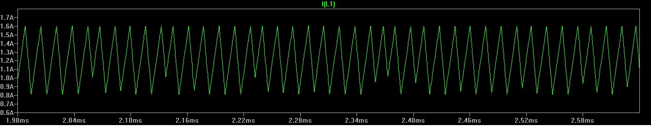

No, my inductor current, with 5us max timestep , is as follows..
.tran 0 100m 0 5u startup
...this is the command I have used in LTspice....I cant see if it is the same as yours

Yes, that command is identical to mine.
I did notice that your ripple frequency is much higher than my simulation. Have you changed the circuit from the one I downloaded?
Try reducing to Maximum Timestep to 1us and see if that helps.
yes I changed it from 1mh inductor to 100uh.......I originally changed to 1mh to see if it stopped the noisiness, but it didn't.
I tried 1us max timestep and it is certainly better, though not as nice as the single comparator case, which I attach here in LTspice

Okay. Try 0.1us. That seems to work well with 100uH in my simulation.
Works well! Thanks! You're a genius, How you knew that waveform anomaly was a feature of the simulator , and not of the circuit etc, I do not know.
...............How you knew that waveform anomaly was a feature of the simulator , and not of the circuit etc, I do not know.
No magic. I've done a lot of simulations and I've seen similar types of anomalies before where a waveform is unstable or has distortion that don't seem normal for the circuit. So then I tried, somewhat randomly, changing some of the simulation parameters until I found one that gave a proper display. In cases such as this, normally the timestep is determined automatically by the program to minimize simulation time, which usually is fine, but for some reason with certain types of circuits it picks timesteps that are too long, causing unstable or distorted waveforms. So you then reduce the maximum timestep manually until the waveform looks normal. But if you reduce the maximum too much, the simulation time starts to increase, so that's why you don't always want to put a short value in for the timestep.
