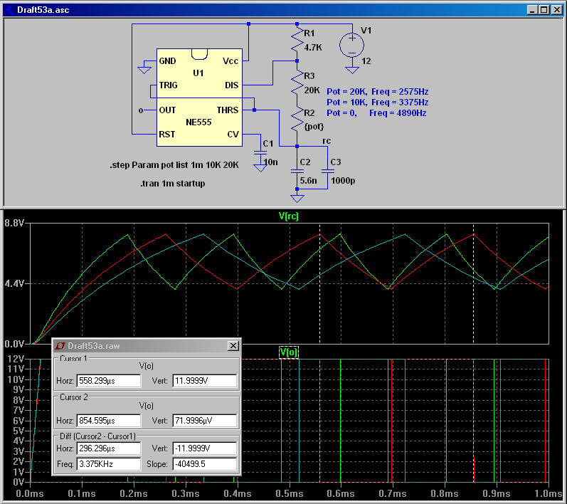

I am trying to bench test various parts for a Robertson AP300 boat auto pilot. I can't get past a "rudder feedback failure" error with an RF300 rudder feedback unit that is likely bad. The RF300 has two wires that connect to the main junction box running at 12VDC. Its specs show a frequency of 3400 Hz indicates the rudder is at center position and each +/- 20 Hz indicates one degree of rudder change to port or starboard.
The RF300 is mechanically connected to the rudder control arm so its arm is probably rotating a potentiometer. If I put an ohmmeter on the two wires its readings fluctuate wildly while the unit is stationary. Measuring frequency with my DMM shows around 4600 Hz at center position, which is way off the 3400 Hz spec so I think this unit is probably bad. How can I create my own circuit to simulate the RF300? I would love to breadboard a simple device that I can use but I don't know where to begin? For example, how is resistance related to frequency? Thanks in advance for any suggestions.
A simple 555 timer chip running as an astable, where a pot is used to control the frequency?

Try measuring at the endpoints. What you may find is that the values are stable at or near the end points. If it appears resistive, then substitute a potentiometer.

Mike's circuit looks like just what I need to fool the main junction unit into thinking an RF300 is connected and I can turn the pot to simulate rudder movement. I haven't used a 555 timer chip before but I'll read up and give Mike's circuit a try. Thanks everyone.

The 555 pin 3 output will have a near square-wave, amplitude a bit less than the Vcc of 12V, capable of sourcing/sinking ~200mA. Make sure that is what it takes to drive the other box?
I get only 22mA at 12.7V to this RF300. The specs don't show any power requirements. Of course, this unit could be bad but I think it's worth trying your circuit. I don't have any nanofarad capacitors around so it may take me a little while.
I want to thank everyone for your help and let you know I have things working. I read up on the 555 then created an astable with a fixed approximately 2900 Hz frequency and hooked it up to the junction unit with no luck. Next, I did a master reset of the junction unit's memories then connected the RF300 and went through rudder feedback calibration in the setup menus and it worked. Apparently, the previously saved calibration settings were sufficiently different from this RF300 unit that it was not recognized. I marked my own center at 3400 Hz and 30 degrees to port and starboard at about 4000 Hz and 2800 Hz. Next, I connected the 555 timer circuit and it was successfully detected at a fixed starboard rudder angle.
Now that I have both the spare RF300 and the 555 timer circuit working, I am confident I could use Mike's circuit to create my own rudder feedback simulator and I may just do that for fun. Thanks again for your help.
