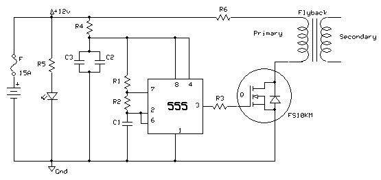

Hello forum! I want to make an isolated DC-DC converter with 12V input. the thing is :
I dont have much experience, so i am looking for the simplest method possible..
Where i leave i dont have access to many IC's, so i need to make it happen with a 555 chip...
I Know this is not a very good way to do it, but in my project i just need to have an Isolated DC source..
i am totally fine with having to use a voltage regulator after the flyback, and i dont care if the Vout will be the same as Vin, or if it will be fixed 5V !
I have found this schemantic :
Which i thing is used to boost DC. Will it work?? What to i have to change in order for Vout = Vin, or Vout= 5V?? also, will 1-1 Transformer work??
Or is it not possible at all?? thanks !!

The output of the transformer is an AC squarewave, not DC. To make DC from the squarewave you must rectify and filter it. Then if the DC output voltage is high enough it can feed a voltage regulator IC circuit.
Why bother with the IC if no regulation is needed? Just use a two transistor push pull oscillator for the primary side and a simple rectifier circuit for the secondary side.
Are you sure you want to built this 555 circuit? You can buy one for $3.26 I built this same circuit.
Here is a photo of the one I built 20+ years ago. I used a 2n3055 transistor instead of a mosfet. The aluminum plate you see all the parts attached to is also my heat sink for the transistor. I have a car ignition coil in the photo. The car ignition coil does not work well above about 10KHz but it will make a spark just as long as a flyback transformer, about 3/8" long. The GIANT filter cap I used is over kill. Dont go over 15vdc it will kill the 555 timer, play it safe stay below 14vdc. The nice thing about the variable frequency is, you can dial in maximum spark length for the HV transformer. Max spark length on the ignition coil is about 5KHz. Max spark length on the flyback is much higher frequency. The flyback does not work well at low frequency.

Look at his circuit drawing it shows a flyback transformer. That is the typical transformer all beginners use for HV= high voltage. His circuit also says, HV power supply. YOU might be right he is talking about 5v regulated after the flyback? That makes no sense if all he wants is 5v regulated he can have that without the flyback. His circuit drawing is identical to the one I built.
i indeed look for 5v :) As i mentioned, i dont know half the things required for this thing to be done.... and i would buy a complete circuit, or even an IC if i could get my hands on one... :) This is why i posted the circuit to you guys :D becouse i dont know if its what i need!

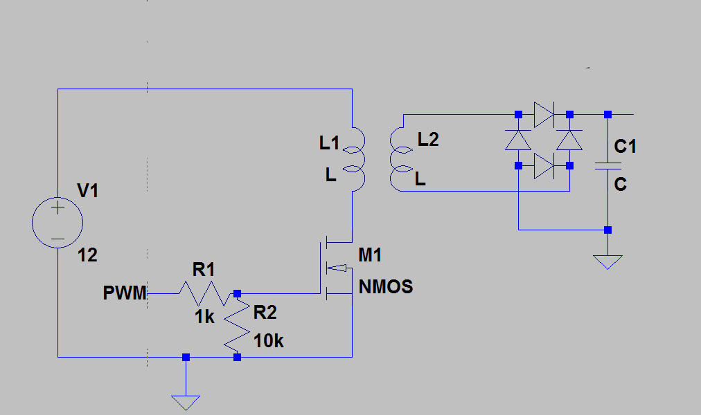

hello forum. thnx to your help i have made something like this working (although its not what we discussed, and it's faaaar from efficient:p )
The transformer is 1-1 ratio. Its a transformer i salvaged from old electronics, so i have no idea about what freq its for :p
The controller , PWM's the mosfet at 31Khz ! The voltage input is 12v, and the output is about 9v :p So, a couple of questions :D
1)what circuit do i need, to change the controller for a 555 timer??
2)what can i do to improve it noise-wise ?
3)what do i need to increase the output current??
4)you think that the voltage drop happens, cause of bad freq used on the transformer, or because of bad topology?? (btw the mosfet heats up ALLOT :D )

The value of the 1k resistor feeding the high capacitance of the Mosfet's gate causes the Mosfet to turn on and turn off slowly causing heat. Use 22 ohms instead but maybe whatever you have driving it cannot supply enough current to quickly charge and discharge the gate capacitance. Maybe you have the 10k resistor very very slowly turning off the Mosfet so it is ramping instead of switching.
A 555 can drive the 22 ohm resistor feeding the gate of the Mosfet.
Nobody knows anything about your transformer so maybe its resistance or your high input frequency frequency reduces the voltage and current. Of course the bridge rectifier reduces the output about 2V.
You don't want any flyback circuit. You just want a self oscillating push-pull arrangement. You can wind the transformer yourself on a ferrite rod. Give it 5 turns per volt and a centre-tapped primary.
2 x BC338 Base resistor 2k2 and some speed-up capacitors. You will get 200mA at 40kHz
