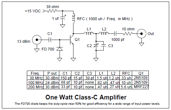

This amp will get you 1W output.

I think he is looking for a range of about 2KM. It doesn't seem like it would take to much if it is line of site?

I think 1 W is sufficient for 2 km if the sight line is clear.

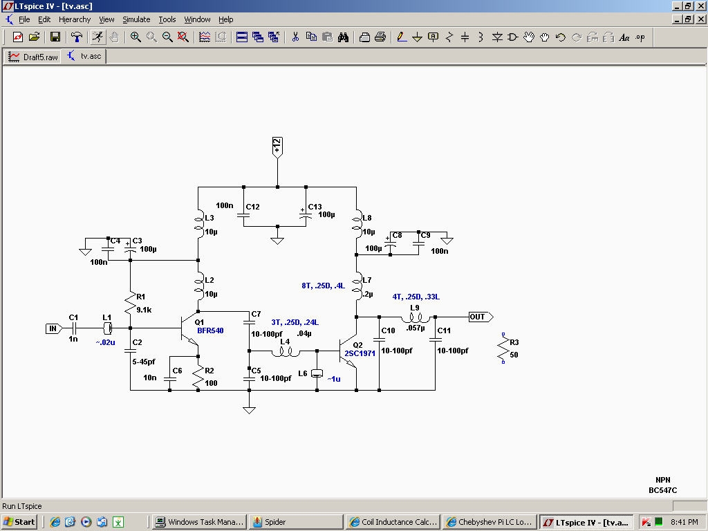

TV Amp
I'm sure this would be a lot easier if I knew what I was doing. :+)
Here is a circuit I found on the net. I think I have resized the L's and C's to around 66Mhz. and added a low pass filter at 140Mhz. Lots of questions:
1- Did I get the LC's right?
2- Is 140Mhz a good place for the LPF?
3- How is the 2SC1971 biased? Is it class C?
4- I'm not sure of the gain.
Think it will work?
Thanks!

This circuit has no detailed description like coil winding details and RFC details. So this is a perfect solution but only fro expert!!! Not to all!! Can anybody provide the details??
