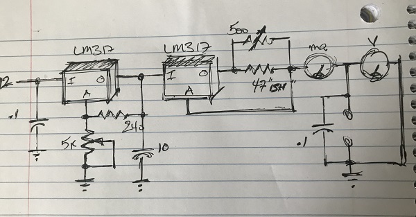

I am doing my "homework" - but there's a lot out there that just looks wrong.
Lots of LM317 based DIY drivers, some wired CC, some CV, some with bizarre component valuers, and some just incorrect.
I suspect the reason that many of them appear to work for their creators is that they're playing with high current diodes that the 317 doesn't have enough output to blow up.
I just want to muck about with a pile of (likely 0.5 - 2 mW max) older LD's in bits of various optical bits I've salvaged over the years - for example a bar code scanning head.
Not really certain how to set up for it though. Seems a typical Vfwd for red is 2 to 2.3 V with current anywhere depending on the device. I don't believe that I have any violets, but probably have some drives that contain them so may want to play in that sand box eventually.
Presumably "any" diode will safely operate (if nowhere near optimal) series current limited to say, 20mA? - so it would appear that a setup with adjustable voltage regulation and a simple series resistor should light anything up without killing it..
But also presumably, once the diode is lit, I'd then want to regulate current.
Of course to what level - as I recall they achieve a certain subjective intensity and then die with an increase in current. You only know you're too far when you just fell through the ice - though seem to also recall that once the device was lasing, additional current had little effect on intensity.
Can you even daisy chain adjustable CC and CV circuits?
I happen to have a nice old 500 Ohm wire wound pot - toss this on the end of a 317 adjustable voltage reg, bring the voltage up until it just lases, and then use the pot to increase current?
Anyone have much experience playing with unknown diode "open loop" play?
As well, are they "tougher" than they once were - or just cheaper? I recall red diodes being in the $450 range in the early 90's: handling precautions as if they were full of nitro, and feedback "mandatory" - pretty sure the dollar pointers must be just running a resistor.
Any help appreciated.
Can't see offhand why something like this wouldn't work, but I've never ganged regulators.
It should work. Left regulator sets the maximum voltage and the right sets the max current. The question is why set the max voltage? If things are working well, the current and diode will set the voltage. (Using a 2 to 2.3V diode at its rated 20mA then 20mA will get you to the right voltage) I think just drive the CC regulator with a reasonable voltage.

It might be worthwhile to set up an LM317 as an adjustable constant current source, say 20mA maximum, connected to a 12 volt power supply and experiment with some LEDs of different colors. Start with maybe 5mA, connect an LED and measure the resulting voltage across it.
The LED will draw the fixed current – the resulting voltage depends on the chemistry of the LED and is called the forward voltage. This will vary a little with the supplied current but it's fixed by the LED. You don't have to control the current AND the voltage and in fact, you CAN'T control both at the same time.

Will they? I've never heard of an LED that has a maximum voltage spec, and they can of course practically operate at high voltages albeit with impractical series limiting resistors - but several LD's I looked at randomly do - and just a few hundred mV above "operating". As well the appear to be extremely sensitive to spikes and ESD - instantly turning from laser into expensive dim LED's.

This is what I have always thought as well but not entirely certain as to why. If the regulators somehow fight, though I'd expect that they'll do so reducing either E or I, but not sending the LD into magic smoke hell.

You need to stop thinking voltage, LED's are current devices, and have a threshold voltage just like a zener diode (and in fact LED's are often used in voltage regulators) - and they don't operate at high voltages, the series resistor 'may' have a high voltage at one end of it, but at the LED end it's just the usual low voltage.
So no need for a voltage regulator, it's completely superfluous.
Laser diodes are just specialised LED's, with more stringent requirements, and much more easily damaged - in old CD Players great lenghs were gone to in order to prevent the LD been killed.
Why can't you understand it?, it's simple ohms law. You can only have constant 'V' and constant 'A' if 'R' is also constant - and you only need either 'V' or 'A' to be constant, the other wil follow automatically because 'R' is constant. But none of this applies to an LED as you don;y have a constant 'R'.
In the series regulator case you drew above there's no suggestion of a constant 'voltage and current', you have a constant 'voltage' feeding the constant current source, and a constant 'current' feeding the diode. The two are not related in any way, and are entirely separate.
The constant current power source can't tell the difference. Who cares?
This had not been crystal clear to me. I have been under the impression that LD's contained some sort of fragile voodoo, and were rather different and unique from jelly bean LED E/I curves.
Why can't you understand it? ... In the series regulator case you drew ... not related in any way, and are entirely separate.
Got it. So the circuit would "technically" function - But all that the first reg would do would be to allow the second to dissipate slightly less power. irrelevant as I'm going no where near max specs anyway. So no point.
So why all of this "driver" stuff if a well regulated power supply and nothing more than a pot are required?
