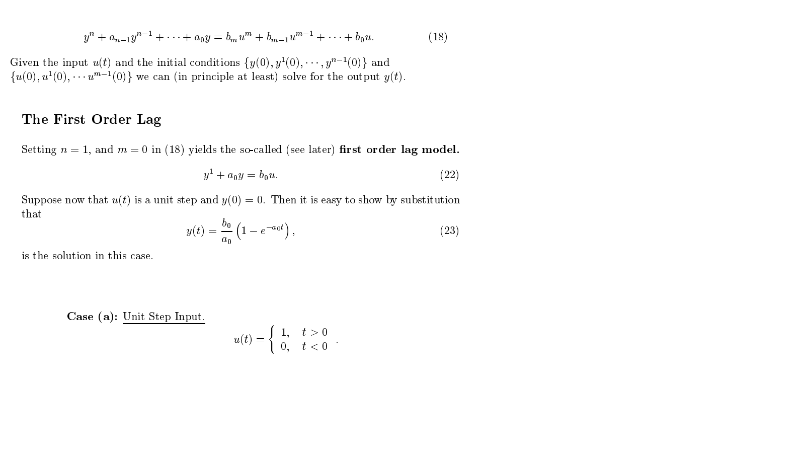

Hey guys,
I am confused as to how the lecturer got to the result in the attached picture (did he use a Laplace transform?) .
Hope you can help!
Hi there,
Havent seen you in a while now.
I was going to say that it's just a first order differential equation that i know you can solve :)
