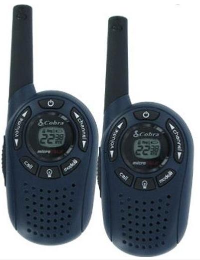

They have some very cheap walkie-talkies that will go farther than 100 yards. I got some for $50, and while their range is about 5 miles, I purchased them probably 5-6 years ago. So I'm sure you can purchase cheaper walkie-talkies with a suitable range?
FRS radios have a range of 0.5 miles to 2 miles. GMRS radios have a range of up to 10 miles.
They are inexpensive, costing about double or triple the cost of cheap toy walkie-talkies..
