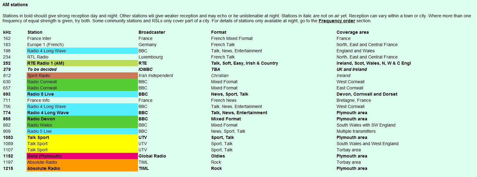

Understand that ANY receiver is, to a large extent, only as good as its antenna.
That said, I would encourage you to re-consider a crystal set.
Admittedly low-tech and without much in the way of audio volume, it will work for you if you put up a decent antenna.
HINT: Night time reception is often (but not always) best.
Since most little xtal kits are for AM, a "long-wire" (the longer, the better) antenna will work quite well.
Here's a list of stations in Plymouth:
NOTE! Be very careful with ANY antenna as they ALL represent deadly potential lightning strike dangers.
