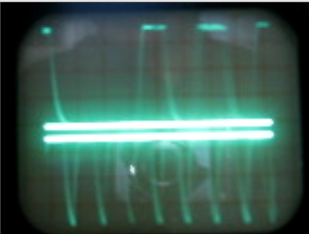

I've now got an image from the oscilloscope, it's not clear, but it is good enough for me to see enough.
I'm still interested in a PIC logic analyser.

You have not stated the X timebase scale on the image.

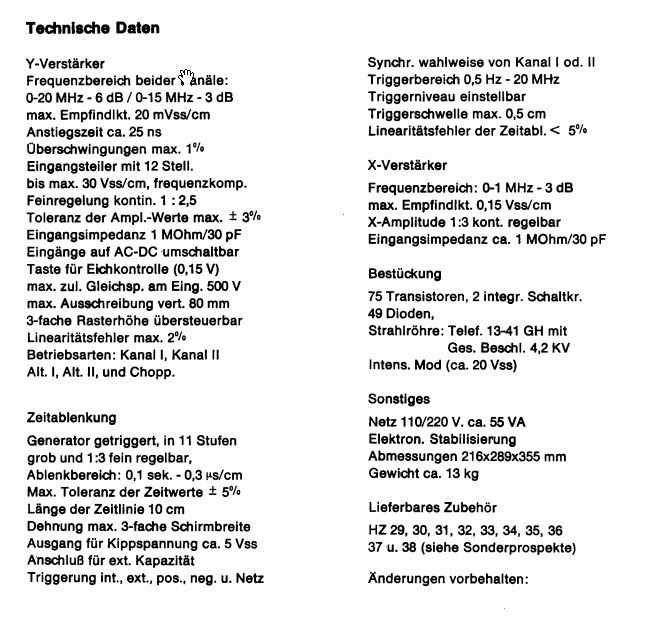

This is a clip from the manual.
E

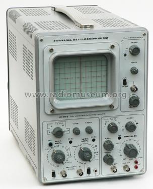

HAMEG HM512 = Two channels, 0-15 MHz (-3 dB)
Found this picture at https://www.radiomuseum.org (museum LOL)
The SPI might be clocking at 10mhz and the scope is 15mhz.
The falling edges are slow and the rising edges are fast. Strange it is usually the other way around. For TTL type signals. Something is slow! With out knowing the SPI frequency I can't say what is slow.
1) Maybe the SPI is good and this is the scope being slow. BUT Then the going up and the going down speed would be the same.
2) Maybe the scope is OK for this speed and the SPI is too slow. Maybe too much capacitance on the bus. (maybe 20mhz)

Is there a way to slow down the SPI clock? Can you change the code?
Hi R,
There is a way of slowing down the SPI, and I tried it, but I couldn't get any sensible signals from my scope.

https://www.radiomuseum.org/r/hameg_oscilloscope_hm_512_2hm51.html

Thanks for the link, if I had time and inclination, I would restore it, but I really should get a more modern storage type, as I'm busy with other projects.

P.S. I got the scope from a museum where I worked, it was surplus, and I could see it was a fine machine.

The PIC in question is running on it's internal crystal, could this have any relevance?

You are using SPI where the clock is sent with the data. If your clock was running 1/2 speed there would be no problem. Even a little unstable clock would probably be fine.
I can not trust your pictures.....If I did trust your pictures then I would say you must have long wires or some problem like that. too many parts on the bus.
