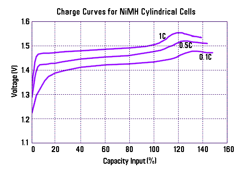

I charge AAA Ni-MH cells with an LM317 at a current of 0.3C and I set its max output voltage to 1.5V for each cell. Then the cells are becoming overcharged because they are getting hot.
I have two graphs that show a Ni-MH cell reaches 1.5V then becomes overcharged and hot.
Since the voltage of your cells is so high then aren't they extremely hot?
I think their life is shortened.

If you use a 0.5C - 1.0C charging rate you could terminate the charge when the battery temperature rises apx 10-15C above the ambient temperature. Two thermistors, a comparator and a flip-flop would be all you'd need for a simple charger.
The other, more popular but difficult, method of charge termination involves monitoring the battery voltage. The battery voltage will slowly rise until the battery is fully charged. When fully charged, the battery voltage will dip by apx 5-20mv. By sensing this dip, which is difficult to do, you can determine when to stop charging.

Energizer shows a typical charging voltage graph on their datasheet. When the current is only 0.1C then the cell is fully charged when the voltage is about 1.4V.
For the longest life Energizer recommends stopping the charging when the cell is fully charged or reducing the over-charging current to 0.025C.
