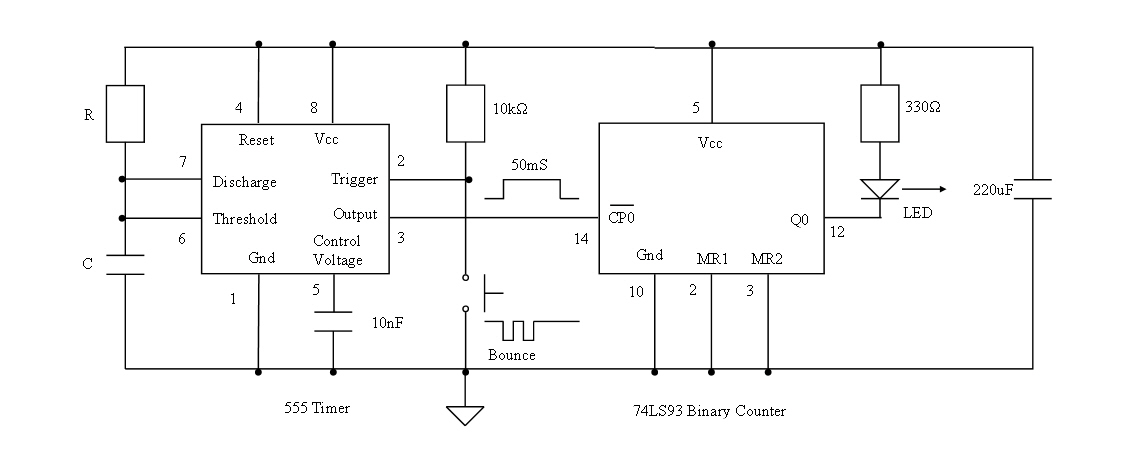

Could anyone please tell me how i can build a simple led, on-off, circuit?
And the LED needs to be lighted with a single push, so i guess i need to involve a microchip?
I have programmers and stuff so i could manage that if someone could tell me how the schematics would be...

Doesn't HAVE to have a microchip... could you simply use a push-on, push-off switch? They are sometimes called "alternate action" switches. Press it once, it's on. Press it again, it's off. Like that?

Microswitch yes, which dosen't stay in pushed position!
There are some examples on Google, i will look for the easiest way, or the smallest circuit I would say.
The smaller, the better
Something involving the 555 seems good
This simple circuit will do it:
