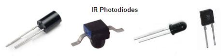

Ok, thank you. But where can I find an IR photodiode? I search on google, and it comes with either infra red LEDs or just regular photodiodes?
An IR photodiode or photo-transistor is in a black case that blocks visible light but passes IR.
I got this photo from Google Images:
Oh, actually I just googled IR diode instead of IR photodiode. Doh! :eek:
I think that answers all my questions, thank you sooooo much, you have really saved me a lot of time and trouble, thank you!
