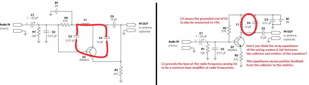

I've successfully built the Simple FM Transmitter from Makezine , which is based on Testsuo Kogawa's design.
However, I have no clue how this works? An internet and Google searched resulted in LC oscillators (tanks). Both of them clearly have a capacitor in parallel with the inductor (at the transistor's collector). It does looks like a Colpitts' oscillator in some modified way. However, I can't really figure out how the FM carriers is generated, and how the amplitude I guess (?) of the input wave is modifying the carriers' frequency (to result in FM?).
Can someone give me an explanation? I (think) I understand the transistor DC principle (that it needs to have fit DC conditions (like 0.7V BE voltage) to amplify the voltage swing at the base. There I'm afraid it stops and I'm eager to know more! :)
Thanks for any help and insight!
An electronic lover eager to learn more about those "analog" circuits! :D
I re-drew the schematic to show that C4 is actually in parallel with the inductor.

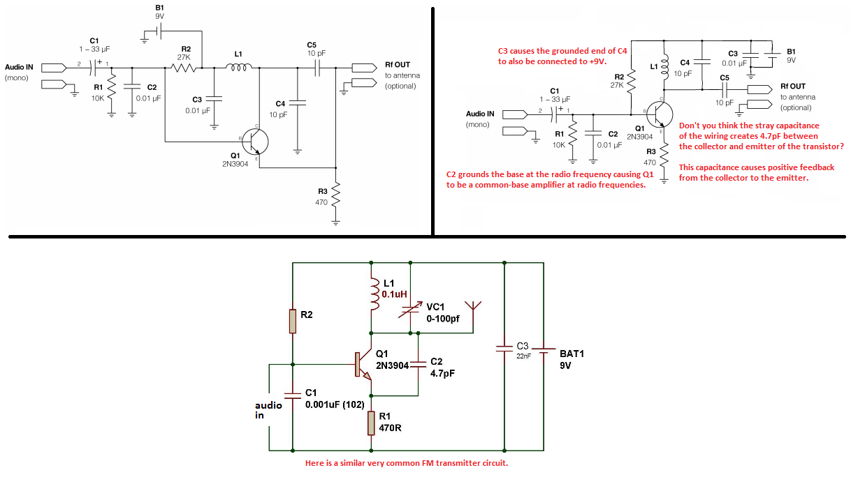

Then I pasted another very similar schematic of a transmitter with 4.7pF (almost nothing) between the collector and the emitter of the transistor.
Stray wiring capacitance easily creates only 4.7pF. Then the transistor is an RF common-base amplifier and the 4.7pF causes positive feedback from the collector to the emitter.
EDIT: The audio makes the transistor conduct more and less. Then the transistor's internal capacitance changes (see its datasheet to see how much) which modulates the oscillator frequency creating FM.

Hi audioguru,
Thank you very much for all the work you've put into the redrawn figure.
Can you explain me why C3 exactly causes the ground end of C4 to be also connected to the +9V. This was the part I didn't figure out when I tried to redraw the schematic myself. I just followed the 'lines' and noticed that the end of C4 is ground (not +9V). Of course I'm sure there is an explanation for that you'll get this C4 parallel to L1. Wondering :)
I understand the stray capacitance thing! :) And I should read more about positive feedback and also "grounding the base at the radio frequency". Some more reading should point me in the right direction for that. If I can't figure out the last two question, I"ll ask. But would be happy if you could explain the C4-magic ;-)
Thank you for your time!
A capacitor across the power supply causes high frequencies to see that capacitor as a short. So at RF frequencies the supply is a short.
On the right hand side the resonant current flows through L1 and C4.
On the left hand side the resonant current flows through L1, C4 and C3. (at RF C3 is a short)(C3 is 1000 times bigger than C4)

Did you look up "common-base amplifier"? The emitter is the input and the collector is the output. The stray capacitance from the collector to the emitter causes positive feedback. Any amplifier oscillates when it has positive feedback and some voltage gain that this transistor has.

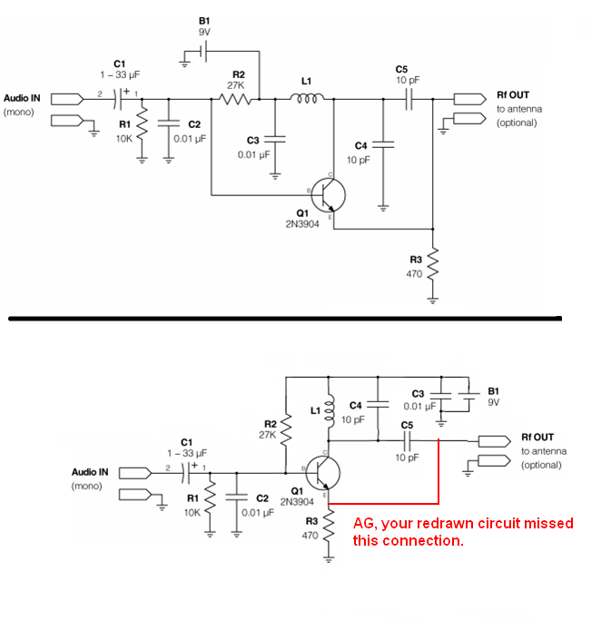

There is a vital connection missing in AGs re-draw of this circuit:
audioguru said-
If audioguru's this sentence is true then a connection added by JimB is not needed, is it?
If stray capacitance between collector to emitter causes positive feedback and the positive feedback cause oscillation then why external capacitor from emitter to collector (like 4.7pf) needed?
Yes, of course. C5 plus some stray capacitance plus the capacitance of the transistor are used for positive feedback.

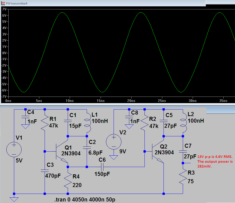

My simulations show that the output level is higher with less distortion when the value of C5 is increased from 4.7pf to 6.8pF.
This is the best I could make it perform:

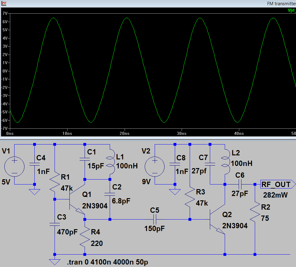

I selected capacitor values so that the output level is pretty high with low levels for the harmonics:

To keep the oscillations going from the tank circuit (formed by L1 and C4), it needs positive feedback. This feedback is provided by the stray capacitance (not shown on the schematic) between collector and emitter.
1) Does C5 (capacitor at the output) has other purposes than just providing AC-coupling to the (optional) antenna? If so, does it contribute to the collector-emitter stray capacitance? Is it correct that the it is not necessary to have the red wire drawn by JimB due to the stray capacitance?
See post #6, I redrew it wrong. C5 parallel with stray capacitance and capacitance insde the transistor provide positive feedback. The antenna is connected directly to the emitter which is the output.
