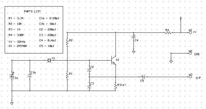

I have a 32 kHz crystal that I want to use as a clock pulse source. I have tried searching the net for oscillator circuits and have found some, but haven't had any luck simulating them.
Can someone tell me, in the simplest way possible, how to reliably make my crystal oscillate? I want to use in a clock and the O/P will go straight into a frequency divider then a counter. I want to ideally run it from a 9v battery, or two (depending on the overall current pull of the system).
Any help would be appreciated.

Ron, I tired your suggestion in my simulator and I still had problems. It seemed to stop after a cycle or two, and the whole thing would freeze up. This is a software problem, not a circuit problem I assume.
So, could anyone tell me if the circuit I have attached will oscillate my 32 kHz crystal? As you can probably tell I've had no experience with crystal oscillators before, so I'm kind of in the dark with all of this! Has anyone used this circuit, or had any experience with it?
Anymore advice or suggestions will be equally appreciated.

Can you post the subcircuit or the parameters for your crystal? I think I can help you. I got a sim to run (with some changes), but I need to have the crystal model you are using.
Ron,
Unfortunately, I have no idea what the crystals sub circuit is! As I said previously, I am new to XTAL oscillators. I was planning to work it all out for myself and teach myself the basics of them, but without any luck.
The crystals that I have (10 from eBay), have KDSIL down the side, and nothing else. I won them months ago on eBay, so the auction page is no longer viewable, so I can't get you any more information! All I know, well assume, is that they are 32 kHz. They are in metal cans which are about 8mm in length and 3mm in diameter.
Can I ask how you got the simulation to run, and what software you are using? Thank you for the help so far though, and sorry I can't provide you with more information.
I'm using Linear Technology's SwitcherCAD III, a totally free, no restrictions version of Spice.
What are you using? You should be able to view the netlist after simulation. The subcircuit for X1 will have the crystal model. If you can copy and paste it here, it would allow me to help you get your sim running. I'll post a schematic here if I do.
I got a 32kHz xtal oscillator to sim by cobbling up a model for a crystal and changing some component values in your schematic. I could post it here, but my crystal model is undoubtedly different from yours.

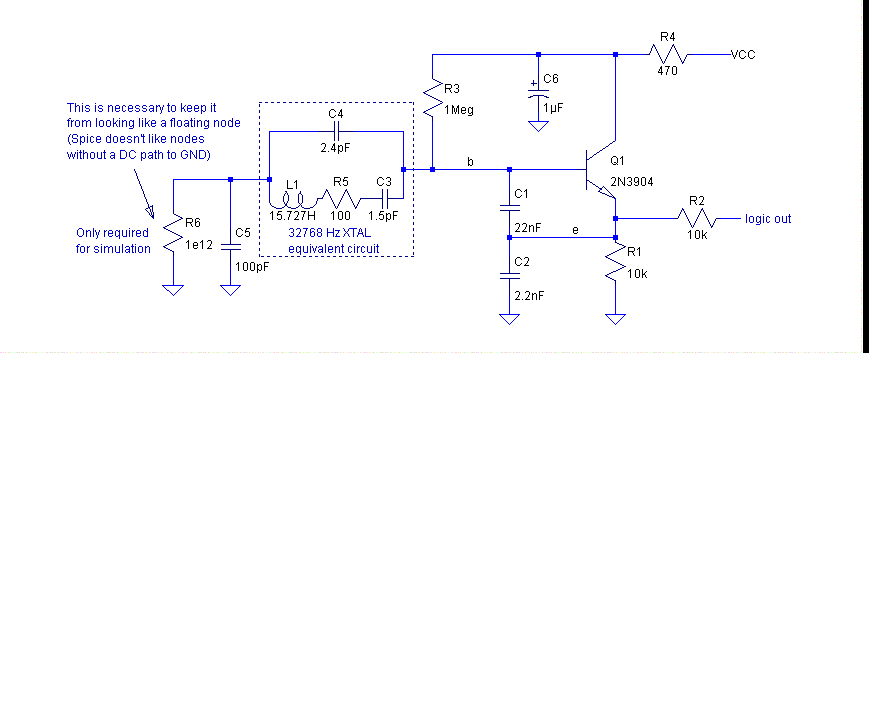

That crystal model you have is for a 10MHz crystal.
Fc~1/(2*pi*sqrt(Ls*Cs))
The attached circuit oscillates for me on SwitcherCAD III. You have to let it run for about a second to get full amplitude. The crystal model is an educated guess, so you may get different results if you build it in hardware.
The output swings from a little below GND almost to VCC. It should drive CMOS logic OK, but you might want to improve the rise and fall times by running it into a Schmitt trigger. If you want to use TTL, we need to talk. :)
