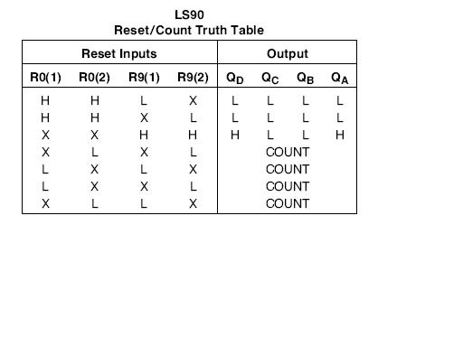

it looks from the truth table in the pdf that if you connect all reset inputs to ground , it should count..
I put one reset to Vcc and the other reset to Gnd equal with the two Set because when I see the table of mode selection I think that I need put them like that :S
Im little confused, for example if I look at the logic diagram, then I think the only way that reset is not launched is that Mr1 and Mr2 are both 1 (because of the nand gate...¿?), but if I connect them to Vcc it dosent do nothing....

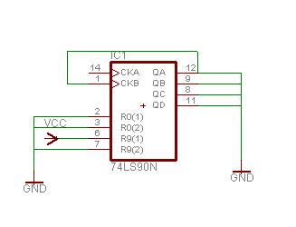

My first eagle :).
Hi here is like I have connected it now, dont know if count ok, because with the manual put of the cable it switch so fast thatt when I see 0001 (in the leds) then I see 0110 :S, I think I need buy a push button ???
By the way, here I dont put any LED, but I have connected them between Gnd and the outputs without any resistors :).
A push botton will do the same thing :( because the chip is counting all the contacts that you are making ..

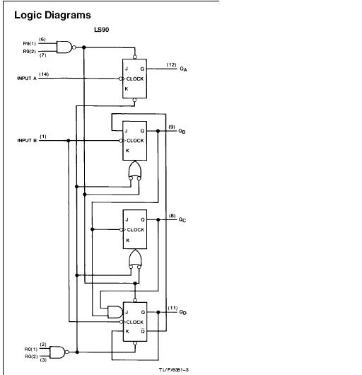

In the logic diagram mr1 and mr2 are connected with a nand?
But in the logic symbol there is a and first??
And in the functional description say:
A gated AND asynchronous Master Reset (MR1 • MR2) is
provided on all counters which overrides and clocks and
resets (clears) all the flip-flops. A gated AND asynchronous
Master Set (MS1 • MS2) is provided on the LS90 which
overrides the clocks and the MR inputs and sets the outputs to
nine (HLLH).
Anyway, I will do a proof/error, but if some one whant to explain me this?

Hi people, Im not able to get ir working in the correct secuence :S You can find the datasheet here **broken link removed** if you whant to check what I say.
I have removed the part of the 7 segment display because is more dificult follow the numbers :S....
Ok, if I put MR 1 and 2 to Vcc it is nothing in the leds (they are turn off)
if I put MS to Vcc then the number is 1001.
There are 14 pins, 2 of them are not used and 2 of them are Vcc and Gnd,
What rest are 10 pins, 2 of them are Master reset (MR) and I have connected them to the Gnd, and there are 2 that are a Master Set (MS) I also have connected them to Gnd.
4 of the 6 pins are for the ouputs and the otehr two are for the clock, I have connected C1(pin 1) to Q0 like say in the datasheet, and the C0 (pin 14) I have connected it to the outpùt of my clock.
I have disassembled it and reasembled it, only one time I remember it coun OK (the number 3 have not the top part, but was counting from o to 9), now I can register with the same circuit this diferent counts....
0, 1, 2, 5, 8, 9
1, 2, 6, 7, 8, 9
and only one time
1, 2, 7, 8, 9, 0
Some one can explain my????, I have watched only the first output Q0 and it turn on and off each aprox .5 seg, is this to fast for the internal update of the 7490??? or what Im doing wrong????
