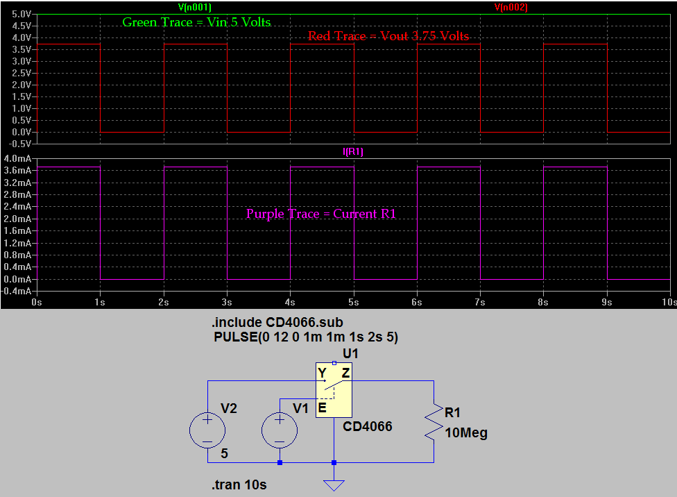

I mentioned CMOS switching earlier, with a focus on the CD4066 quad bi-lateral switch. The problem when measuring voltages through one is the large losses. It just isn't in my opinion a good solution if you are scanning many inputs in data acquisition where accuracy is important. See the below image that simulates a CD4066 with a 5 volt input. My output is about 3.75 volts of the 5 going in.
That is why I believe most high speed data acquisition systems that scan multiple inputs mux using a relay card.
Just My Take
Ron

I(R1)*10Meg=37.5KV?

My bad on the sim. The load was 1K and not 10 Meg. That drops the voltage. I wish we knew exactly what the OP was measuring?
Ron
That makes the chip look better than its data sheet. 3.75V@1K implies an on resistance of 333Ω.
