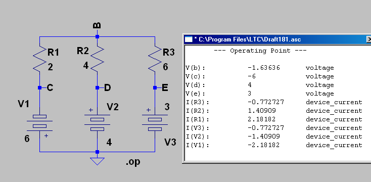

First, lets see what LTSpice says: (note I swapped the position of V2 and R2 to make it easier to visualize. I also labeled the nodes differently than you).
Now, using algebra:
Σ of currents into node B = 0
I1 + I2 + I3 = 0
I = V/R
[V(c)-V(b)] + [V(d) -V(b)] + [V(e)-(V(b)]
--------      -----------    -----------          =   0
    2             4              6
6[-6-V(b)] +  3[4-V(b)]  +  2[3-V(b)]
-----------------------------------            = 0
               12
-36 -6V(b) +12 -3V(b) +6 -2V(b) = 0
-3V(b) -6V(b) -2V(b) = 36 -6 -12
-11V(b) = 18
V(b) = -18/11 = -1.36363
Now that you know V(b), you can solve for the branch currents.

MikeMl,
I believe you reversed the battery V3. The voltage at node b should be -18/11 = -1.64 .
PG1995,
The node equation is (Vb+6)/2 + (Vb-4)/4 + (Vb-3)/6= 0 ======> Vb=-18/11 = -1.64
Ratch
