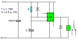

You want the light to snap off, or can it extinguish slowly? How watts/amps is the bulb?
Use a 555 timer and a relay to produce a timer relay.
The bulb goes in series with the normally open relay contacts.

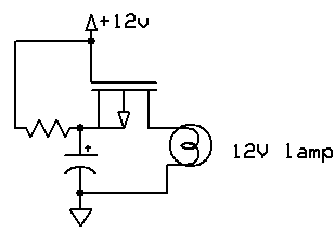

Here is a circuit I just thought of. It uses a P channel mosfet as a high side driver. Initially the capacitor is discharged and the mosfet is fully on, as the capacitor charges the mosfet will turn off.

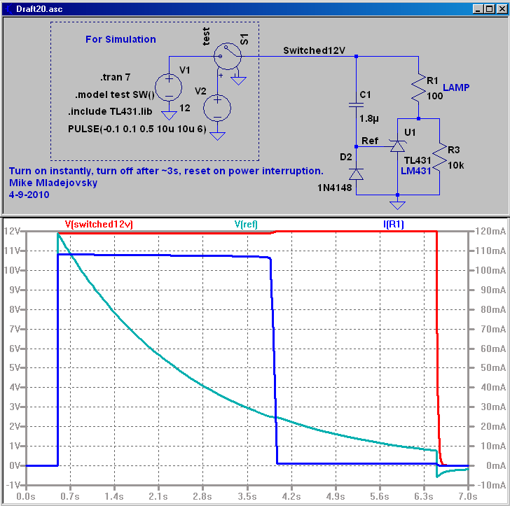

Try this one. Uses my favorite part, the LM431. It does the delay each time power is applied, and resets when power is removed, even for a short time. It is the input bias current of the LM431's opamp that charges the timing capacitor. The capacitor discharges through the diode, the lamp, and the 10K resistor.
It works once when the capacitor is discharged. However, when the 12V is disconnected, there is nothing to discharge the capacitor. I had to add the diode and resistor to discharge the timing capacitor for each subsequent cycle.
The gate voltage never changes. I'd connect the gate to the juncton of the resisitor and cap, and connect the source to ground.

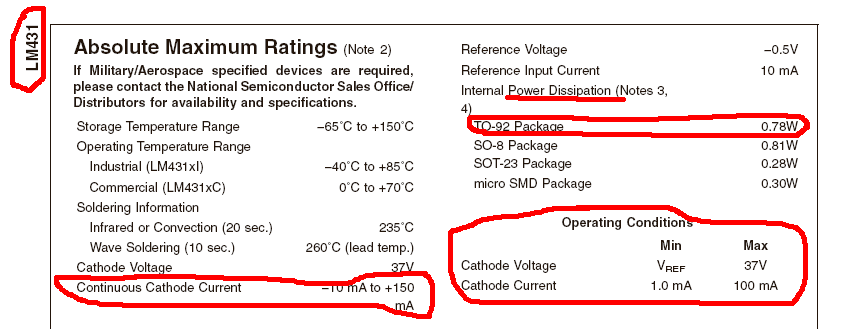

The absolute max cathode current rating for the LM431 is 150ma. Most GOW lamps are ~75mA.
Don't you mean the TL431?
The datasheet for the LM431 says 100mA, the TL431 is rated to 150mA.
I just went and looked up the National, TI and Fairchild versions. All three are the same as the partial data sheet for the LM431, below:
Sorry, yes of course you're right, I was confusing the recommended operating current with the absolute maximum rating.
