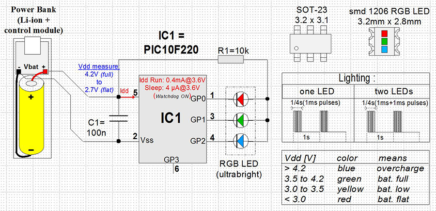

Simple Battery Charge Indicator from EDN
As long as you can write code and have the tools to program the PIC....
Actually, the code is available. The same limitation applies to any microcontroller, no? But to me, the important part is the idea. It can be implemented using whatever technology you like.

The PIC solution has uA draw in sleep mode between readings while the LM3914 draws 3mA in standby mode and you'll need additional circuitry to toggle it between enable and standby.
I wouldn't use a $3.70 device (LM3914) at end of life only available in a 20PLCC SMD package when you can do it with a 6-pin device at $0.60 with fewer external components? Writing the code is minimal and any microcontroller can be used - more of a concept than a single solution.

There are obviously many ways the three LEDs with different forward voltages can be used to make a voltage sensor. It doesn't have to specifically be a PIC, even a low duty cycle cmos555 could be used to flash at a given rate for a given duration.

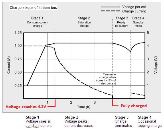

Looking at the graph in www.batteryuniversity.com , a lithium battery reaches its fully charged voltage of 4.2V per cell long before it is fully charged because it is still drawing charging current. Its current drops to a low amount when it is fully charged.

The tough part with programming means the microcontroller needs to measure state of charge but that specific micro has no internal or external voltage reference - vdd is always full scale regardless of battery charge. So one ADC channel will need a voltage reference and one measure the battery voltage, then flash any of the lights as needed. The LEDs could be arranged in come "charlieplexed" format to optimize useage of the four I/o pins and ADC.
