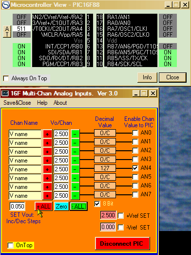

Hello All; I am trying to make a very simple ADC program with a PIC16F88 which reads only one input at AN4. The PIC has a 10bit output which I want to be shown on pins RB0-RB7, RA0 and RA1 by just sending a logic 1 or 0 to each pin. I am using MPLAB IDE and MPLAB SIM as the compilier. I notice there is an error which says ADC-W0008: No stimulus file attached to ADRESL for A/D. which I don't understand. I know the code is very close to what it needs to be but I am missing something subtle....Any suggestions or comments would be GREATLY appreciated here! Thanks in Advance....
And also, what would be the best way to test this? Im currently using a pot to vary a dc voltage at the input AN4 with a range between vdd and vss....will this suffice?
Attached is my .asm file

hi Steve,
Your program runs OK in the Oshonsoft simulator.

Thanks Eric; That makes me fuul much better....
I changed the code so the output is only a 8bit resolution, and I would like to send these values to RB0-RB7 respectively and have them be held high or low so I can read the output with a voltmeter at the pins....Do you see any issue with how I am sending these values to PORTB so i can read them? Thanks again!
Steve

hi Steve,
If you post your latest code I will give it a run in the Sim.

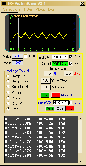

Hi Eric; Thanks again i really appreciate it. Attached is my latest version. And again, my goal is to read the outputs on PORTB respectively.
Steve

Downloaded it, ok
EDIT:
Required editing, this now works.
Remember for 8 bit operation, its left justified and in ADRESH
  • A_D Conversion Code.asm
Hi Eric; Thank you very much for editing my code. I see everything working as planned now. I understand the changes you made and I see where I was going wrong. Knowledge is power!
Thanks Again!
