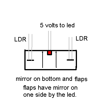

This would make a good accelerometer. How it works is it has three mirrors in it two on the led side of the flaps. And one on the bottom, with the LDR facing down out side of the flaps. When the car or what ever you put it on
accelerates they move back by the amount of force to make your car move. Which angles the light from the led towards the LDR. Which lowers the resistance by how much force is applied. You could also use it for sensing tilt.
I made one with ball and spring to see if the car moved but with flaps and mirrors you have better precision if you wanted to use it for tilt. It starts at 112K and gos down to 20k like turning a adjustable potentiometer very good control.
I guess people think this is big or hard to make it is only a 1/2 by 1/2 by 1 1/2 inch the mirror is made of
paper you get it at hobby shops. The flaps are hinged on a piece of copper wire with copper foil and the mirror glued to it an I coated it with solder for more weight. Here a pic of the first one I made not to good looking but it worked as good or better then what you can buy. And it cost less then a dollar to make.

be8, it might be nice if we could see the actual sensor in that video, also it's going to be so mechanically sensitive it couldn't be used in any situation where there'd be high shock forces or vibration. Accelerometers are not that expensive.
You can tell shock same way sparkfun 27.00 Accelerometers dose it calibration. Acceleration is shock like the force that pushes you back in the seat when you hit the gas Or the shock of some one hitting your car in the rear end. Still Acceleration.
I was raising it with my hand. I wanted to see the voltage change more then watch it raise. I could fix it so vibration is not a factor. It should hold up good. I was thinking about using it where there is not much vibration
I like what you are doing with DIY sensor but here size works against you.

Sturdier things are more massive, but they also fall a lot harder. You should now work on a home-built vibrating gyro.
This would be fun **broken link removed** I have most of the junk to make it and I think my sensor would work out find to help keep you up right.
Accelerometers don't work for things like that. As soon as you accelerated forward, the platform would knock you on your back (or vice versa).
You no I always jump the gun . I was thinking about tilt control. It has two sensors and you could find the middle. It can tell if you tilt forward or backwards. With some fast Adc I'm sure you could keep it upright.
You still would need a gyro. ADC speed isn't the problem. It's that the acceleration when moving would skew the gravity reading making it think the ground is not quite where it actually is. Two sensors don't help either because acceleration skews both sensors in the same direciton.
I don't have any good links to gyro when you google you get food I done ate Lol. I see what your saying But I think there a way to make it work like I'm thinking. If it tilts back one LDR will increase in voltage and one will decrease in voltage. That will tell which way your moving. Now if i compensate for acceleration I could keep it upright. May work but if not still some thing to do. I like the ideal of a gyro but it would have to be big to keep me upright.
