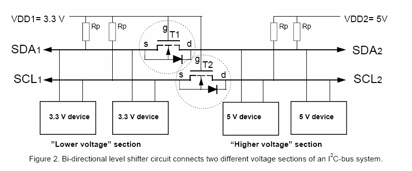

Came across this simple level converter for programming 3.3V chips with a 5V programmer but have yet to try it myself, looks like it might work.
Comments?
Looks pretty slick. Took me a while to figure out that PGD/DATA are bi-directional lines, right?
how is the circuit with double transistors and four resistors better or worse than this level shifter with two resistors and one transistor?
image borrowed from sparkfun
That circuit, provided by Sparkfun, was (possibly) originally suggested in Philips AN97055 "Bi-Directional Level Shifting for i2c bus and other systems", pictured below.
