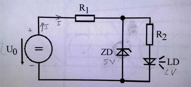

Here comes the first one - I have the following part of an exam problem (don't lough, that's one of the easiests).
There is a zener Diode in the middle as a voltage regulator which hase a Zener Voltage of 5V. The input voltage is initially set to 11V. R1 = 150 Ohm. The Light Diode (LD) has U=2V.
a) What should be the resistance of R2, so that the LD would have a current of 20mA by U(LD)=2V. Answer: 150 Ohm
b) What current flows through R1 and what through ZD? Answer: 40mA, 20mA
c) The input voltage is now set to 9,5V. What current is flowing through the LD now? Answer: 20mA
d)The input voltage is now set to 6,5V. What current is flowing through the LD now? Answer: 15mA
This exactly is my problem - how come and why is the current of d) 15mA!?? My answer would be 20mA as before!? is it my mistake or is the given answer wrong? I do get the previous answers... but maybe I am not solving it right :confused:

With a 6.5 V supply, there isn't enough current flowing through R1 to maintain 20 mA in the LED.
Therfore no current at all flows in the zener diode. The current in the LED is (6.5 - 2)/(150 + 150) = 15 mA
The voltage on the zener is 2 + (0.015 * 150) = 4.25 V
So at 6.5 V supply the zener does nothing at all.

Hi Perky123,
I think Diver300's answer did not explain for you to understand. So I'll give it a try.
Supply voltage=6.5V, R1=150Ω, R2=150Ω, forward voltage drop (Uf) of the LED=2V.
My calculation looks like this: (Vs-Uf)/(R1+R2), in numbers: (6.5-2)/(150+150) or (6.5-2)/300 or 4.5/300=0.015A=15mA.

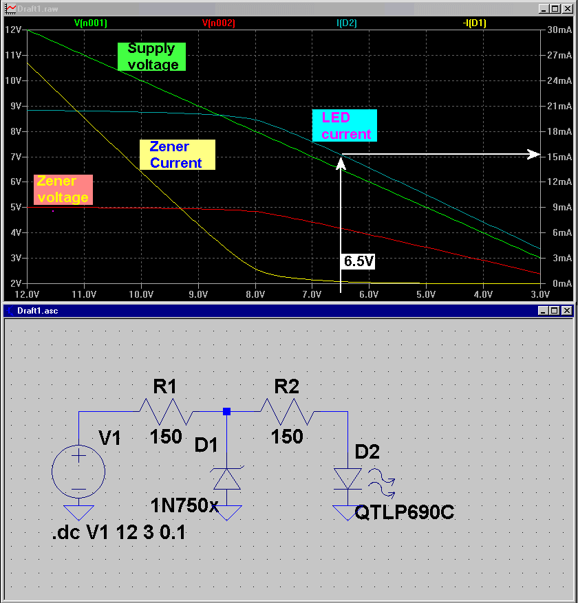

You can study the attached diagram where I gradually reduce the supply voltage from 12V to 3V and you can see how the voltage and current varies.

No. If one disconnects the zener diode but the junction voltage(between R1 & R2) is already lower than the 5V zener voltage, the zener "cannot" bring it up to 5V. This is exactly what happened here. The LED and the two resistors formed a network with the junction between the two resistors being less than 5V so the zener has nearly no current flow.

It would be 6.5V - 2.0V (Vld) = 4.5V/2 (R1 in series with R2) = 2.25V drop for R1 and R2. Add this 2.25V (R2 Vdrop) to the Vld of 2.0V and you get 4.25V at the junction of R1 and R2. Divide the 2.25V by 150Ω and you get 15mA. This is what eblc1388 was saying about the junction voltage being lower than Vz. If Boncuk is right and the zener has a breakdown current of 10mA, than by his calculation, the total current in the circuit would be 10mA. Since current splits at the parallel junction, you can't have 10mA flowing through the zener and 15mA through the LED. This would be a total current of 25mA, which does not compute. Eblc1388 is correct. He is also correct in stating that the Vfd of the LED will be less at 15mA than at 20mA. But your instructors opinion is probably "close enough". Spoken like a true technician. But, if this is an engineering course, he needs to be more precise.:)

You do it in the reversed sense.
1. Assuming there is 5V across the zener, so R2+LED will takes 20mA as previously calculated.
2. Now decide what current one wants to flow through the zener so that it will do its job efficiently. In this case, one can choose any current between 5mA ~ 10mA.
3. Assume we select 5mA and 10mA as two typical case and see what happens.
4. The sum of these two currents (LED 20mA + zener 5mA or 10mA) flow through R1 and by ohm's law voltage drop across R1=25mA*150=3.75V or 4.5V respectively.
5. Now the supply for this whole network is easily worked out by adding this voltage to 5V across the zerer diode. Giving you 8.75V or 9.5V for these two particular cases.
So you'll find out 6.5V is way too low for the zener circuit to work.
