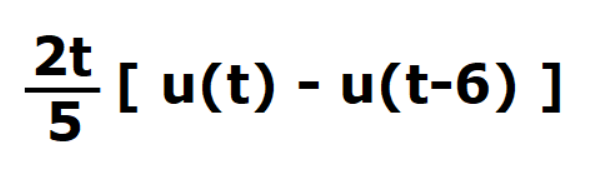

I am having a hard time solving the following question about signals and systems, and I need to plot its graph:
(2t/5) *[u(t)- u(t-6)]
Tools offer a solution, but I want to understand the logic behind how it is drawn. in other words, he expressed it with a unit digit function in this expression, but we need logic, how do we draw it?
If anyone knows and can help, it will be greatly appreciated.

So if you expand the expression you get 2tu(t)/5 - 2tu(t-6)/5
So first term is a ramp of 2t/5 starting at the unit step (which enables
the ramp when = 1, eg for all t > 0) which occurs at t = 0.
Then you have another ramp starting at......
Then you sum (perform subtraction as second term is - going ramp)

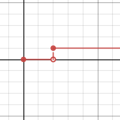

Now what about the function u(t). u(t) is just like that:
u(t) for t<0 equals 0,
u(t) for t>=0 equals 1.
But sometimes we see other things inside the parentheses like t-7 rather than just one value.
What we do then is also very simple, we perform the subtraction first.
u(-7) as we know equals 0, but what about u(t-7).
Well, all we have to do is perform the subtraction first t-7 and see what we get. Now if t=0 then we see:
u(0-7) which of course equals u(-7) and we know that u(-7) equals 0. On the other hand, if t=9 then we see:
u(9-7) which of course equals u(2) and we know that since 2 is greater than zero u(2) must equal 1.
You might do a couple of those by hand before proceeding further here.
u(t-3) for t running from 0 to 10 would have output 0 from t=0 to 3 and have output 1 from t=3 to 10.
Note that the output for t=0 to 3 is not perfectly correct it is actually from t=0 to 2.999999999 because at t=3 it changes to 1. We have to run t for all t not just integers, so right up until we reach 3 the output is 0 but as soon as we reach 3 it goes to an output of 1. I am using mostly integers here but the time has to run over all fractions also like t=2.1, t=2.2, t=2.3, etc., and even t=2.001, t=2.002, etc. When we plot this we have to realize that there is some small step involved but in theory the step is infinitesimally small.

u(t) must be 1 for all t from 0 and higher, and
u(t-3) must be 1 for all t from 3 and higher, and 0 for t from t=0 to 2.
We can plot both of those separately.
Next, wee see that together inside the brackets they are subtracted:
u(t)-u(t-3)
and so we have to subtract them over t from 0 and up.
Since u(t) is 1 for all time from 0 and up, and u(t-3) is 0 from t=0 to 2, from t=0 to 2 we end up with output
[1-0]=1 for t running from 0 to 2.
Once we get to t=3 however, the second term kicks in too. That is 1 for t=3 and up. That means now we have:
[1-1]=0 for t running from t=3 and up.
These two solutions [1-0]=1 and [1-1]=0 can be plotted, and here it would look like a pulse from t=0 to 3 and at t=3 it would go to zero.
We also have a multiplier here too though. It is 2*t/5, but let's say it is just 2*t for now. I think you know this is a ramp, but because we have those two terms inside the brackets we actually have two ramps. The first ramp is:
2*t*[1-0]=2*t
and the second is:
2*t*[0-0]=0
This means for t running from 0 to 3 we see a ramp that goes up as 2*t which means it ramps from 0 to 6, and after that we see 0 for t from 3 and up because 2*t*0=0.
Now the actual problem has 2*t/5, but you should be able to figure out how that changes the plot of the ramp.
