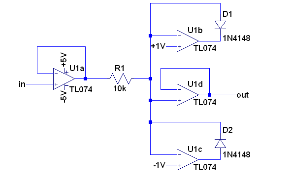

i was given a task:
i am supposed to build a circuit that clips a signal source (signal generator) output to a voltage range of +/- 1V. this voltage range will then be used as input to a sound card. thats why i need to make sure that the input voltage to the sound card must not exceed 1V peak.
i was thinking of using diodes where i used to see it on other circuits, connecting the output to the rail or something. but i could not get the precise design out.
any idea how can i do that? or any BETTER idea on how to clip the signal at 1V
thanks
One method is using a special version of a opamp voltage follover, where you put in a diode like pic below:
However, this only limits the maximum positive voltage. You need to design a "reverse" circuit where the diodes shifts directions and you'll us -1 volt on the Vlimit input.

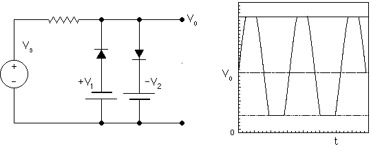

i have seen some circuits that look like this:
Opamp Voltage Limiting
this example was given as a internal block of an op amp.. i wonder is it a usable circuit, or its just simulation of concept. but somehow i have seen that diode configuration in some NAND gates... 74SL family i guess...
any idea how it is done to clip a voltage of +/- 1V?
diode clipping will create bad distortion. Would the nominal signal be under the threshold of the diodes.
This will clip at ±1V. It will also severely distort the signal if the input signal swings past ±1V. If you don't need high input impedance and low output impedance, you can omit U1a and U1d, and use a dual (TL072) op amp. The +1 and -1V references can be high resistance voltage dividers.
The supply voltages can be as high as 15V each, and they don't have to be equal in magnitude.

hmm...
i just remembered that i have seen the op amp circuits before...
but this circuit will just work fine right?
if i connect any circuits to the soundcard, should i take care of the current that will be flowing into the soundcard? -- even if i have limited the soundcard input to +/-1V?
