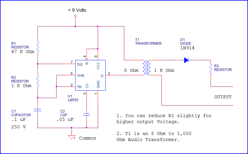

I am working on a mini project, 'shock Book'. Its a small pocket diary-like book. I want to use a capacitor, so when the book is closed the capacitor charges and when the book is opened the capacitor dicharges, i.e. the person gets a shock. I don't ant the person to suffer..lol. Just a little shock when he.she opens the book. Could someone help me with the design.

Try something like the attached drawing. Slightly modified version of what I mentioned. Designed to have a neon lamp at the output. T1 is just a small 8 Ohm to 1 K Ohm audio matching transformer. They can be had about anywhere. R1 can be reduced "slightly" for higher output voltage. I would not go below 39 K Ohms. The 555 is an oscillator driving T1 to produce a high voltage on the T1 secondary. It should work as drawn. You will need to place your switch inline with your 9 volt supply. Anyway, this is about what I was getting at in my previous post.

The circuit above does not work because your body does not react to DC. Even though spikes are produced, the pulses of 80v - 100v are not felt. The diode and resistor have not effect whatsoever.
If the output is AC you will jump with a voltage as low as 60v - 80v.
As I pointed out, the posted circuit was originally for a small NE2 bulb and thus the resistor and the diode, not that a NE2 bulb needs a diode. As to the whole DC thing? Remove the diode and resistor but I would still venture you would feel the DC.

Simply try the circuit and see that IT DOES NOT WORK.
And why won't it work or should I just take your word for it. 80 to 100 VDC will give a shock just as easily as 80 to 100 VAC will. The 555 is outputting out a square wave with a PRF of about 150 Hz to the transformer. So why won't the circuit work? The circuit will work just fine.
Ron

OK colin55 I tried it. I tried it about 28 years ago when Forrest M. Mims published the design to ionize a NE2 bulb and I tried it again finally today. I got a shock. Plain dry fingers and nothing fancy and I got a shock. Additionally I lit a neon NE2 bulb mch as it did 28 years ago.
There was a minor caveat. There is a .1 uF cap across the transformer output. I did try a few small transformers I had lying around with mixed shock results. I finally went to a local Radio Shack store this morning and bought a part number 273-1380 and interesting enough the part number hasn't changed in 28 years or so. Using that circuit it produces a mild shock. It produces at least 80 volts or so to ionize a NE2 bulb and produced a mild electric shock which is what I believe was the goal of the original poster.

Here is a circuit that will work:
ZAPPER - 160v
This project will give you a REAL SHOCK. It produces up to 160v and outputs this voltage for a very short period of time.
The components are taken from an old CFL (Compact Fluorescent Lamp) as the transistors are high voltage types and the 1u5 electro @400v can also be taken from the CFL as well as the ferrite core for the transformer.
The CFL has a 1.5mH choke with a DC resistance of 4 ohms. This resistance is too low for our circuit and the wire is removed and the core rewound with 50 turns for the feedback winding and 300 turns of 0.1mm wire to produce a winding with a resistance of about 10 ohms for the primary.
The oscillator is "flyback" design that produces spikes of about 160v and these are fed to a high-speed diode (two 1N4148 diodes in series) to charge a 1u5 electrolytic to about 160v. If you put your fingers across the electrolytic you will hardly feel the voltage. You might get a very tiny tingle at the end of your fingers.
But if this voltage is delivered, then turned off, you get an enormous shock and you pull yours fingers off the touch pads.
That's what the other part of the circuit does. It turns on a high-voltage transistor for a very short period of time and this is what makes the circuit so effective.
Nice circuit that will really have someone let go quick! Yeah, if I wanted a shock book or shock anything that would be an excellent choice. Better than my suggestion.
