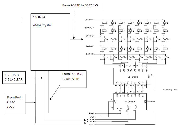

I think i should make it clearer , this is how i connect my hardware part.
Note that i didnt connect ULN2803 in my board currently , because i have enuff current to run my 5x5 board.
It would be simpler to use a 4017 and arrange the display as 8x5 so you only need a "run of five."
The coding has already been done in the 5x7 Display on talkingelectronics.com website.
How are you sinking the columns?
You are not shifting 5 times. You are shifting 8 times.
In the circuit you provided, it needs 8 shifts.
You need to deliver 7 "1's" and one "0'" to get one of the columns to illuminate.
This "0" must be shifted. This must be set-up before outputting the highs from the micro to illuminate the column.
How are you shifting the 1 0 0 0 0 0 0 0 pattern

It's latch which your chip has none. But are you holding pin 9 high the clear pin your drawing shows clear not hooked up if so it will only load data one time if your not holding clear high which is pin 9 on a p-dip I looked agin you have it going to the pic hook it to vdd and try your code.
I looked at your code and it's not holding it high a 74ls164 loads data with clear high you do that one time in your code But if it gos low it will not let it load data which is what you have going on here.
