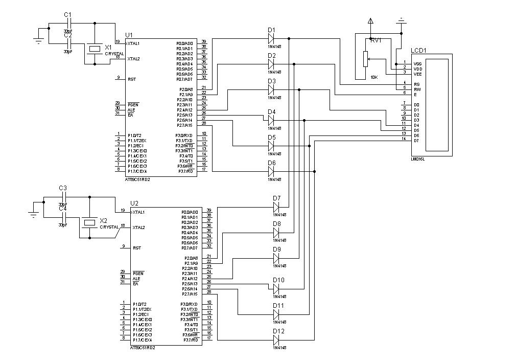

I have two microcontroller 8051(P89v51rd2) boards and have made an lcd board having two set of output pins available for each lcd pin.
LCD is given VCC,and Gnd separately. And the microcontroller boards have a separate power supply and power supply switch(with the grnds of each of the boards and the lcd unit connected together)
Two set of connector wires connect each of the pins rs,rw,en,d0-d7 to each of the two microcontroller ports.
The LCD is always powered on.
Now when I switch on one of the boards(say board1) while the other is powered off ,there is nothing displayed on the LCD.But if I now disconnect the LCD connector from board2(the other board) and then again restart board 1 ,it works perfectly fine.
Similarly if I switch on board 2 and remove LCD connector from board1,it too works fine.This implies that each of the unit works fine independently.
But when both connectors are connected with only one of them switched on it doesn't work.
So what I think is that sharing of LCD pins to the other microcontroller affects the voltage levels at the microcontroller LCD PORT ouyput even though the other is switched off (i.e. its pin40(VCC) is disconnected from power supply).What I have proposed is that can connecting low voltage drop diodes(like 1n4148) and the LCD port pins of microcontroller solve this problem by keeping the voltage levels fixed the individual ports?
Please comment and suggest some solutions for the same.
If you want any info regarding voltage levels at the pins or any other info please do ask.
You should not connect active outputs together, diodes will not solve your problem.
Even though the power is off in one of the 8051, it will 'sink' thru its internal diodes any external signal.
You require a data selector IC.

You need to consider what components are inside the unpowered IC.
Assume you made a small section of the internal circuitry on a project board and the board is not powered in anyway.
If you tried to measure the resistance between two points of your circuit with meter, the meter test voltage would find the least path of resistance thru your circuit, it would not necessarily measure open circuit.
The same applies to the 8051's one powered, one not.
If say one active pin [ an active pin is either set low or high] of the powered 8051 is connected to a pin on the non powered 8051, it could find a conductive path thru it to another pin.
Remember you are talking of a number of pins linked in this way.!
Are you using the RW pin on the LCD.?

Look at the HEF4053 IC, you would need two.
Note: you would have to reinitialise the LCD whenever you change the selection.
Can you say why you need to power down one IC and share an LCD.?

Which way around do you think the diodes should be in order set an LCD pin High or Low.???
As Bill suggests, post a diagram.
@3v0 & @erricgibbs
In the schematic I have attached ,the power pins for each of the uC is not shown and also I haven't shown the other peripherals attached to the ports of each uC.
So considering that I have separate power switches for each of the uC,will this arrangement solve my problem?
